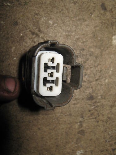

Last Fall I had the same problem except it was only with the speed sensor. I found out one of the pins on the wiring connector going to it was completely missing. To fix it I put some old wiring in the place of the pin and it worked. Now the problem has come back to haunt me.

I think it was the faulty speed sensor connector with the missing tooth that caused the problem. I did measure the connector and found it had a 17 ohms reading, so there was continuity. I found one on ebay. I should be able to graft this into the wiring harness easily right?
VSS Speed Sensor Wiring Plug Honda Civic Integra vtec 3 Wire Acura | eBay
This a 3 WIRE VSS VEHICLE SPEED SENSOR WIRING PLUG FROM A OBD1 1995 ACURA INTEGRA B18b1 LS
Attached Thumbnails Help, AT problem, throwing Code 15 and Code 4-%24-kgrhqnhjfye-k9slcrubptcuity0g%7E%7E60_12.jpg
