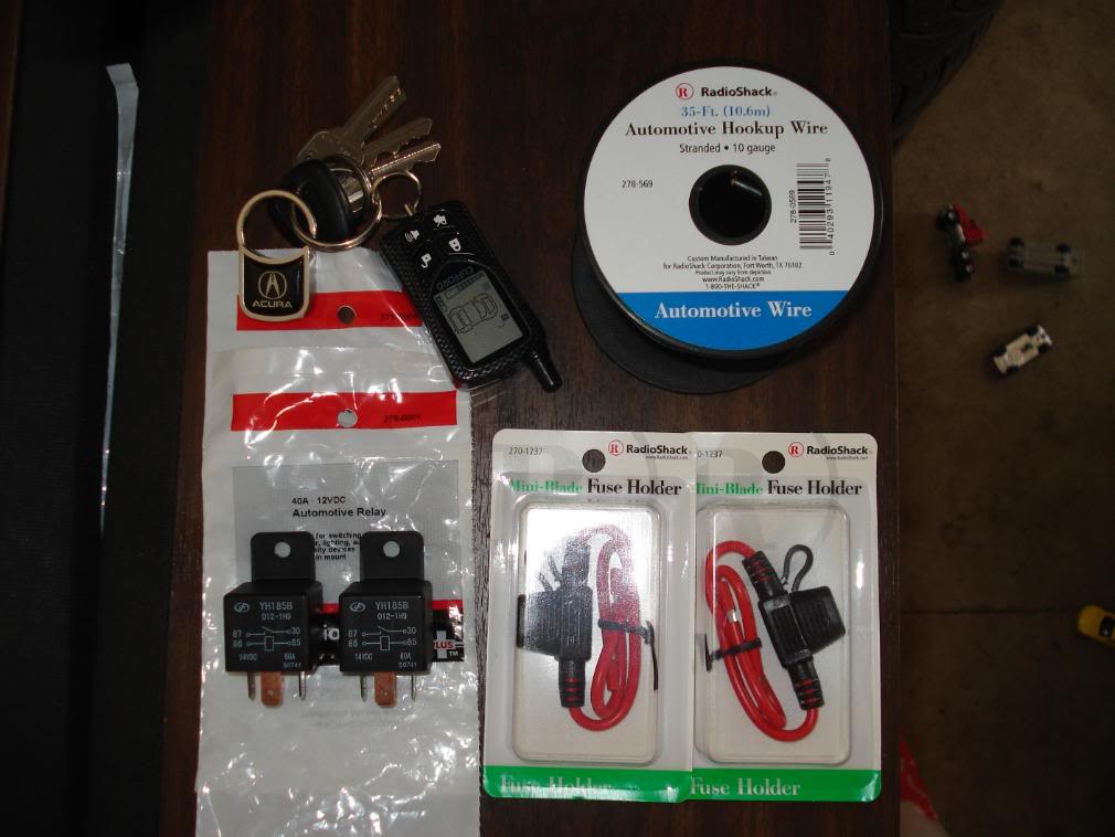

Go to Radio Shack and venture over to their drawers of electronic gizmos.
Huge picture warning!

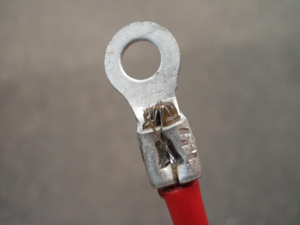

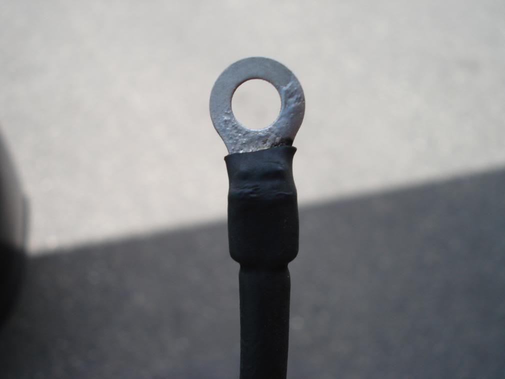

10AWG wire is a bit overkill. But 16AWG or bigger will do the trick. You'll also need to get some ring terminals from the hardware store that will fit the standard 10mm bolt you'll find throughout the engine bay... the headlight bolt in the radiator support is a perfect example. Then you need terminals that will connect to the tabs on the relay, I forget what exact type they are. I got the weather tight ones, but it doesn't really matter.
You'll also need a wire stripper with the ability to crimp the terminals.
Soldering and heatshrink is optional, but it sure looks purty!

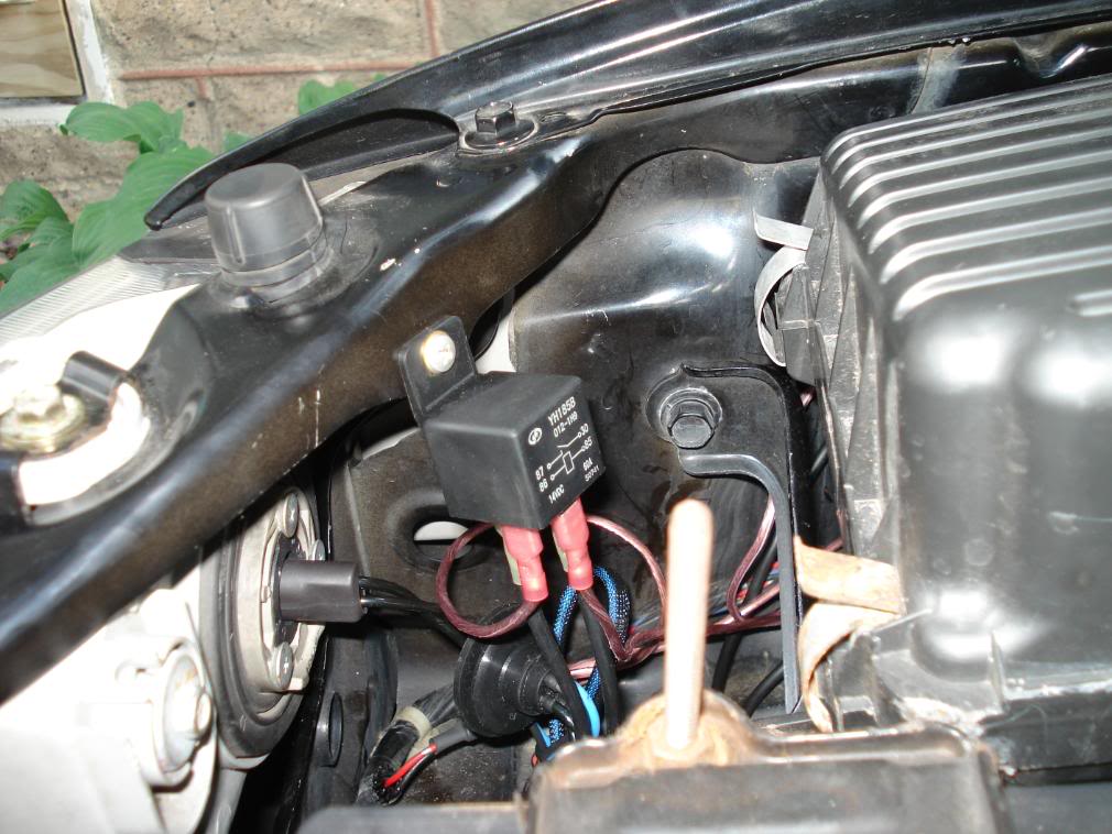

Relay mounted and connected:

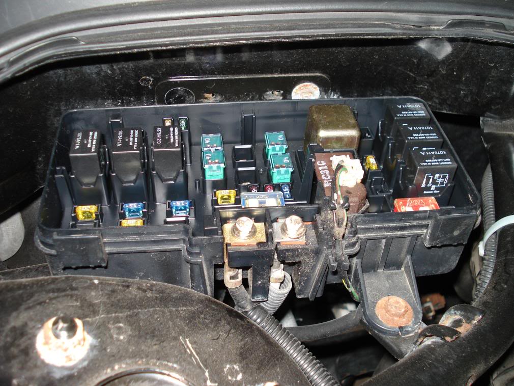

Where I tapped in for power (looks much cleaner than running them right off the battery):

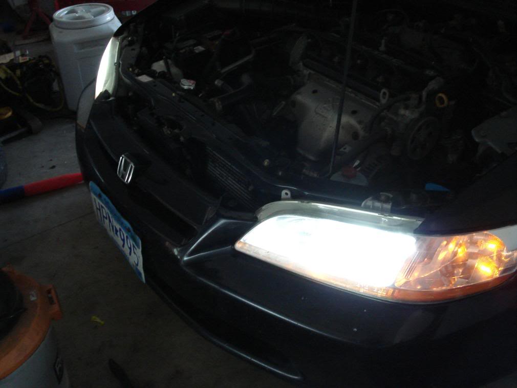

TA DA:

To give you an idea of how beefy the relays are, you can clearly hear them click inside the car with the engine running.

The stock bulb plug was clipped and the leads were connected to the really to switch it and the connector was soldered to the power leads on the relay. So really, the HIDs are still plug'n'play, but they get their power elsewhere. And then, if a bulb goes out, I can just disconnect the ballast and plug in a good ol halogen bulb.
