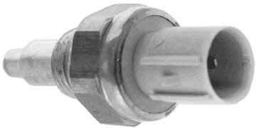

You are having the coolant temprature sensor checked...Yes?
Old Nov 22, 2010 | 10:09 PM
Lightbulb Take A Look At This Item
It should look about like this Image below.. click image for bigger picture.
Attached Thumbnails Honda Accord 1987 LX -- While PARKED, RPM raises and drops constantly-213-725.jpg

So my coolant temperature sensor should look like that? If it doesn't what would it look like? I need to find where it is, but I'll definetly check that.

The surging idle can be caused by air in the cooling system. There's a little air-bleed bolt in the thermostat housing (#22 in the picture). Open it a bit & see if air comes out.
I looked around the parts drawings for 87 LXi and I didn't find the temperature sensor. I hope someone chimes in who knows...
Old Nov 24, 2010 | 01:34 AM
Posts: 16,334
From the shop manual you can download from the online manuals thread in the DIY section, there is a sensor in the radiator.
Also look to see how to properly bleed air from the system when refilling coolant. That could also be your problem.
