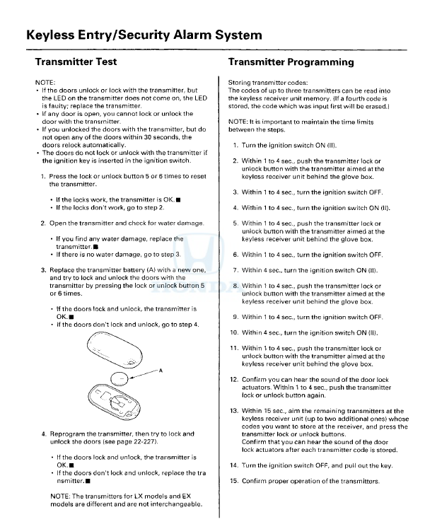

Hey guys, this is my first time being here so I am sorry for any misconceptions or any confusion.
Anyways, I have a Honda Accord 2002 and I want to program a new key fob to my car because the current one that I have right now has messed up buttons where the rubber for the buttons are extremely dug in to the point where it hard to press any button. I've tried programming the new one by following the programming instructions online but I can't seem to get the car into the programming mode. Thank you and any advice and help would be greatly appreciated!

Do the instructions you used match these?
Anyway, the "new user" area is mostly for welcome & introductions. So I'm moving this to General Tech.
Attached Thumbnails Honda Accord 2002 Key Fob Programming-1998-2002-transmitter.png
