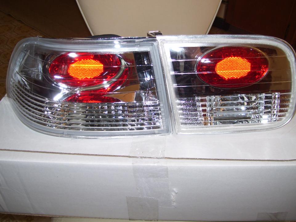

You need to put in the model of your Civic..what Trans you have and what is your engine #..for instance on the block or valve cover..This number for instance is for a 1999 thru 2000 Honda Civic SI (1.6L DOHC) which I used to have years ago..by the way I had a ProCharger Super Charger on this one..so put that into your Signature area of your User ID..this way members can tell more of what your looking for .
Attached Thumbnails Honda Civic CV shaft-hondaciviceuros1992to199%602dr%7E4dr-002.jpg
