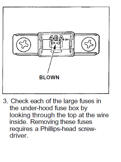

It can be a severely discharged battery; but, check the battery fuse. See images from owner's manual. If it is blown, disconnect negative battery cable first before attempting to remove and replace. Also only replace with the same amperage. If it is an 80A, replace with 80A. If 100A, replace with 100A.

Will check the battery fuse, no owners manual came with the car and I havnt had the chance to browse Ebay for one yet. Thanks for the info.

Checking and cleaning battery cables and terminals was my first action. Being a mopar guy Im not used to under hood fuses, and with no owners manual I didnt know to look for them. After redbulls post I went and found the fuse box and yes, the one labeled "battery" was blown. So off to the parts house to buy a replacement (and a spare) after dinner. Thanks for all the help, now off to the rest of the board to figure out how to mod this thing
