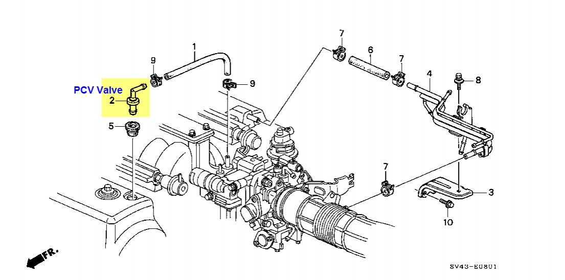

To try to improve your gas mileage, check tire air pressure when they are cold. Get a good tire pressure gauge, such as a digital one; some of those cheaper $1 - $3 gauges can give you wrong readings.
Also, change the PCV valve (it's not shown in the owner's manual) to try to improve gas mileage. It's only a few bucks at a local auto parts store. But, around $20 U.S. at Honda dealerships. You just need a pair of pliers to squeeze the hose clamp to during PCV valve replacement. See attached pic. for location of the pcv valve.
