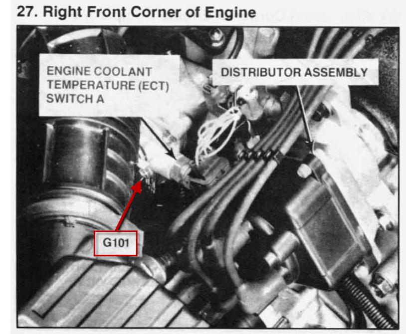

The ignition control module (ICM) is inside the distributor, if the whole distributor was replaced, then the ICM was replaced.
If the Check Engine Light doesn't come on with the ignition key turned to ON or Accessory for at least two seconds, then it indicates a possible problem with the ECU and/or grounding wire. Check the ECU ground wire (G101) located on the thermostat housing (see pic.).

Thank you might be right because i took out the thermostat i will check tomorrow.

Thank you uys so much for the help turn out it indeed was the ecu ground wire under the thermostat.
