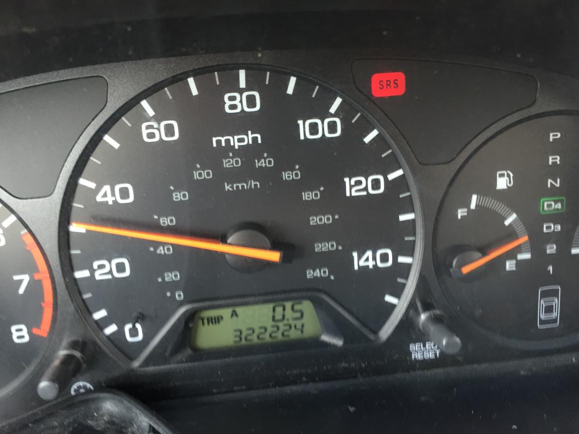

Here is a pic.

Looks like the driver's side seatbelt receiver needs to be replaced; that should get rid of the annoying SRS light.
