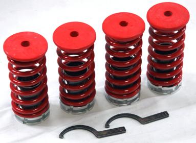

so i bought adjustable coilover springs and they just dont look like they will work. the springs are so much smaller, am i gonna need new shocks/stuts as well?

coilover springs are ALOT smaller if you are comparing them to factory. They are shorter and skinnier too. What coilovers did you buy?

i bought some not so great ones off ebay,
1990-1993-HONDA-ACCORD

ehh I wouldn’t trust them. They don’t even give you a spring rate??.wtf?!?...IMPO don’t use them. Suspension is very very important parts on your car. Don’t cheap out if you don’t have the money to spend to do it right...then stay OEM. Otherwise you WILL have problems down the road. btw ebay coilover sleeves are notorious for snapping. IF one breaks your screwed. You can wreck and hurt/kill yourself and or others.
