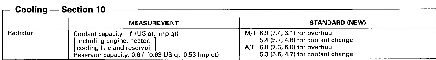

Old Jun 3, 2014 | 12:13 PM
Posts: 7,101
Cooling capacity (including engine, heater, cooling line, and reservoir):
MT - 7.4 U.S. quarts for overhaul; 5.7 U.S. quarts for coolant change
AT - 7.3 U.S. quarts for overhaul; 5.6 U.S. quarts for coolant change

Old Jun 6, 2014 | 04:01 PM
jerrym's Avatar
Almost A Senior Member
Joined: Jul 2008
Posts: 226
From: Maryland
Cool
RB,
You are correct, and very sorry for any confusion. My numbers were listed under the radiator replacement section, which also includes the reservoir. I went back to the manual coolant section and it lists "total system capacity" at 7.4 quarts (MT) and 7.3 quarts (AT), as you mentioned in your reply.
Thanks for the clarification,
Have a great weekend!!
