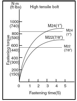

BTW, here's a rather neat Makita chart which graphically shows the relationship between time-of-application and torque. (I assume the "time" is AFTER the bottom of the head of the bolt makes initial contact with its "mating" surface.)
Of course this is for Makita's TW1000 only - I assume that each particular wrench will have its unique curve, but I think this shows quite clearly the general relationship. Of course, in the case at hand of loosening a bolt, I believe that the same holds true.
I think the problem would be that the particular tool has to have enough "top end" torque to "break free" a bolt which has been tightened originally to 160 ft-lb. There must be some corrosion or otherwise just plain getting stuck which makes this job particularly chanllenging for man or machine. Maybe just starting the engine thousands of times tightens the nut further and further.
