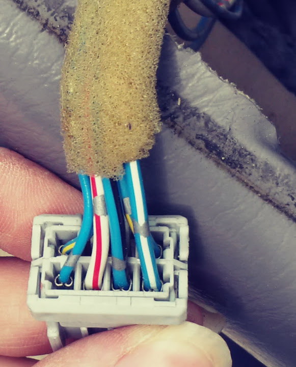

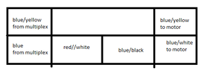

Well, since apparently I never met a lost cause I didn't like, I went to the salvage yard and got some more switches. And guess what I discovered? The front 6-pin actually is supposed to be wired the same as the back ones (both multiplex wires on the left side, both motor wires on the right side). Here's how it was on the two 02s I found that still had their passenger doors.
So the service manual was correct (the version that had the brackets for the different 01-02 connector locations), and the ETM was incorrect (it had the two blue/yellow wires reversed). However, when I wire it as shown in the SM the motor automatically runs when the key is on (and fries the switch and/or the fuse), and when I wire it as shown in the ETM the switch functions halfway normally (will run the motor in one direction when pulled up, does nothing when pushed down).
With this in mind, am I still looking for voltage drop on the wires to the motor, or something else?
