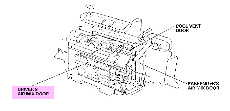

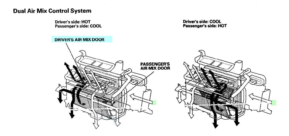

The air mix motor controls/operates the air mix door. The air mix door directs the flow of air (hot or cold).
Your model has dual climate control, where there is a separate driver's side air mix control motor and a passenger side air mix control motor controlling the respective driver's side air mix door and the passenger air mix door. In your case, the driver's side air mix motor probably is not working; so, the driver's side air mix door does not change position to direct air properly on the driver's side. It probably is stuck where it is not directing fully hot or cold air on the driver's side. Your passenger side sounds like it is working. Attached are illustrations of the flow of hot and cold air via the air mix doors for dual climate control. Hot are the black arrows and cold are the white arrows.
On models with manual A/C, without dual climate control, they only have one air mix control motor.
The blower fan running means that probably is okay (the blower motor is a separate motor and located behind/under the passenger dash side).
Edit: Your driver's side is not getting the proper temperature mix of air. Your car still has a mode control motor (Vent (face area), Heat (feet area), Heat/Vent, Heat/Def, and Def) and a recirculation control motor. If just the driver's air mix control motor was bad, it doesn't mean no air flows.
