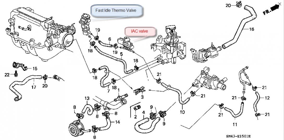

the antifreeze hose running into my FITV burst the other day, so of course, when one goes the others are not far behind. Bought new hose and replaced them all, but I think I may have mis routed the 2 small ones coming out of the T-stat housing going into the valve, and the throttle body respectively, because now I have the telltale honda idle surge when it warms up. So does it go top hose to FITV and bottom hose to throttle body? or vice versa?

Refer to attached cooling hose parts diagram for routing.

thats exactly what I needed. thank you sir.

I seriously think I crossed the routing. after looking at the diagram.
