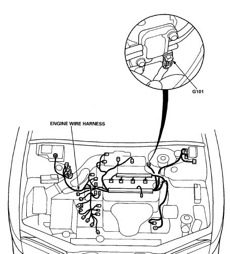

Yes they should be dry. Sounds like the tube seals are leaking.
While looking at it, check the ground (G101) on the end of the TB/plenum just to be sure it is clean and tight.
