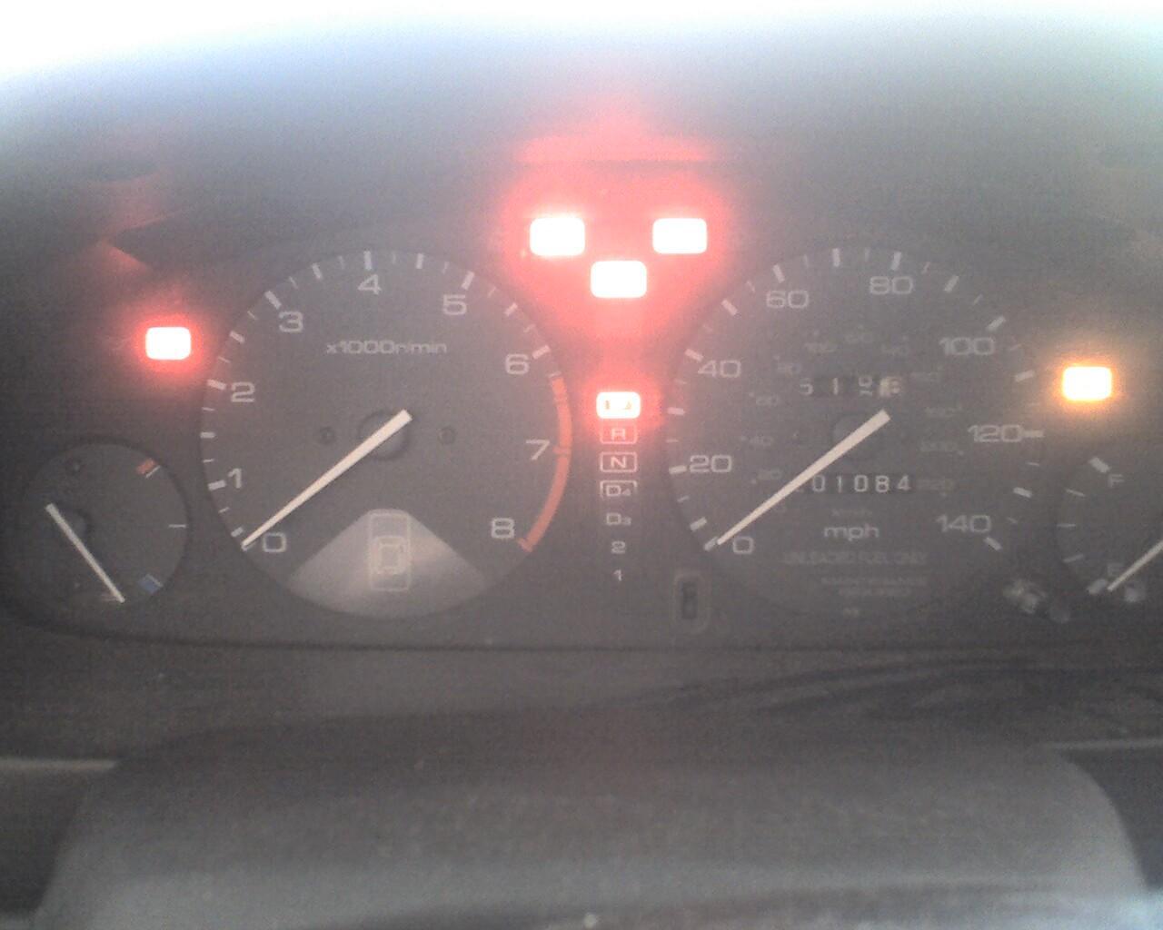

ill take a picture of the dash cluster to show u waht all lights are on when i turn the key
this is what im seeing

First thing to fix is the starter circuit. Maybe left some wire disconnected at the starter? The starter circuit is big dumb electricity. No sensors. No intervention by any computers.
It just clicks when you try to start... Where is that click sound located?

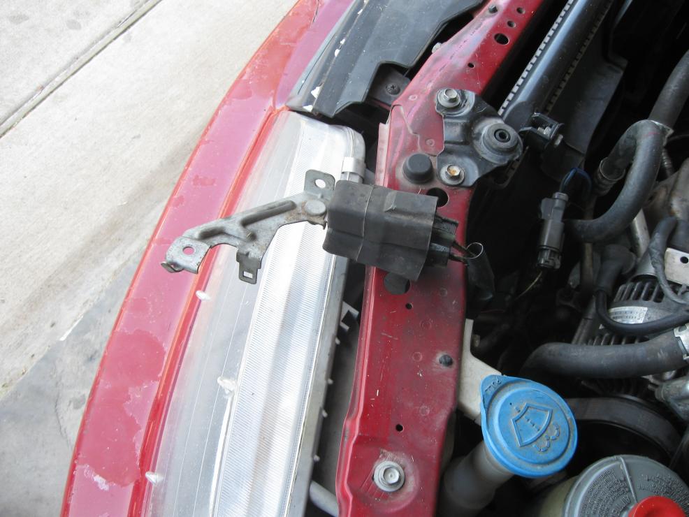

ok, i know the cv axels are not in all the way so that was one of my codes. i dunno the others. but i have a couple of pictures that i need to post.
i need to know where this bolts to........

does anyone know where this goes?
