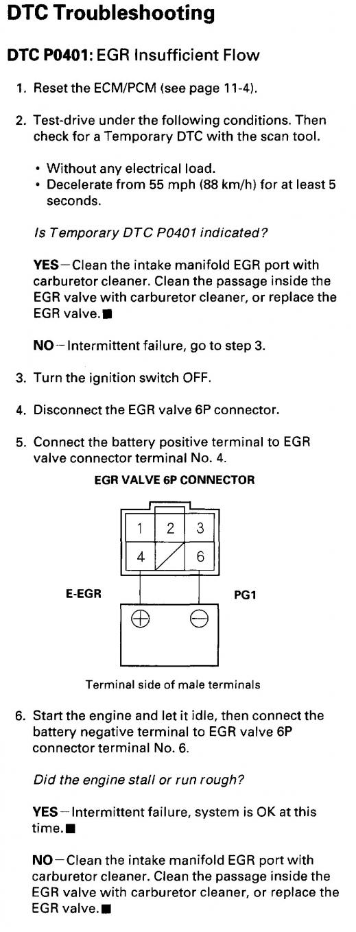

here's the troubleshooting for the EGR code, and no, the gas flapper is probably not related.
