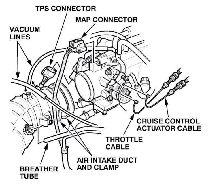

So I cleaned the port put everything back together. When I started the car it had 4 codes instead of the regular po401. Now it says throttle position sensor low input, map sensor high input and its tellin me to check the owners manual for the last one. My car is runnin like poop can't get it higher than 3000rpm and it falls right back down. Please help.!
Old Jul 22, 2012 | 05:13 PM
Check that the electrical connectors for the TPS sensor and map sensor were not switched.

Default Fixed P0401 and now have P0108 and P0122
So I fixed my insufficient flow code now I have P0108 which is map sensor high input and P0122 which throttle position sensor low input.? Can anyone hellpp me I have to drive to workk.! What could I have done wrong.?
Old Jul 22, 2012 | 08:25 PM
I combined your other separate post.
As stated previously, check the connectors for the two sensors. I believe the MAP sensor connector is gray and the TPS sensor is blue. A lot of people inadvertently reconnect them wrong.
