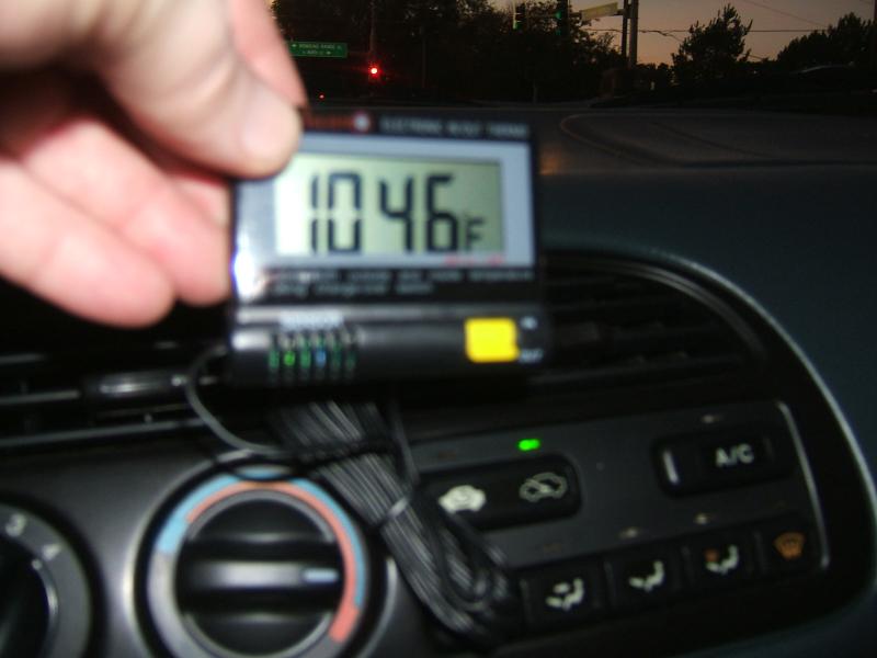

But the '97 heater doesn't put out as much hot air as the '93, not by a long shot. So ran test.

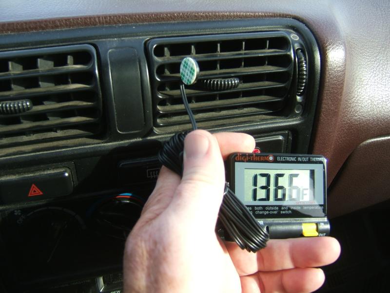

* The '93 puts out 136F air from the dash vents when it's 50F outside;
* the '97 dash vents deliver 104F air in 60F outside temps.

'97 Accord heater air temp from dash vents

'93 Accord heater air temps from dash vents

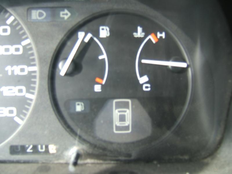

Now here's the temp gauge at normal operating temp for this particular '97 car. Weak heater. The needle is angled DOWN; is this hot enough?

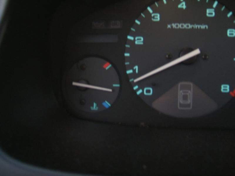

Here's the temp gauge for the '93 car at its usual operating temperature. Wonderful heater. Needle is angled UP.

Your temp gauge for the 97 looks just like the one on my 94 (same indication) and my 94 heater works wonderfully.

Even though your temp guage reads normalish (I drove a 94 accord for 200k mi), how old is your thermostat? If it's stuck open a bit, given how precise those temp guages typically are, you still could be running cool, causing the heat issue.

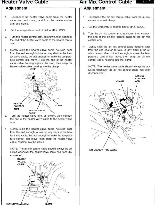

i have a 97 accord and its got this exact same problem.
i was trying to fix it this morning, i try to adjust the air mix control, i believe the problem is the cable from the heater valve to the heater control arm is not long enough. so that's why you can not set the temp to max. i can turn it to max but it will bounce back to the position in your pictured. the valve i believe is at the max flow position. i was manually able to turn the heater **** to full/max heat position and the heat is there. it did put alot of tension on the heater valve arm puller the coolant tubes a bit. when it's at at position picture the blend door is not fully open so thats why the air is not hot, if the cable to the heater valve is like 3/4" longer i think it will turn to full. so did you had this resolved yet?
Attached Thumbnails insufficient heat?, or normal?  '97 Accord-heater-cable.jpg

Damn, must be cold where you live if 1046F won't keep you warm.

1) can you manually push/pull the heater core valve on the engine side of firewall near the thermostat? If it won't move fully forward and back, the valve may be the problem. The valve should move easily.
2) Check the wire from heater control under the dash to heater control valve for bends/kinks. I had one on a Toyota bend/kink and would not move the valve until I rebent straight.
3) The connection of the control mechanism to the wire requires adjustment to get full travel. I did this once but don't remember the exact procedure. I recollect simply forcing the wire to full open or closed position (don't remember which) and fixing the retaining clip to hold the wire to the controls.
