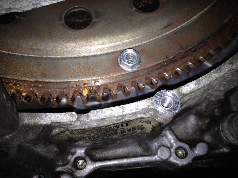

Here's a pic of the flywheel with the transmission inspection cover removed. The guys told me to wear goggles and buckle up, oil should be pouring out of it (if one has a rear main seal leak).
In fact, there is a very small drain hole there that I could see was dry before I even took the cover off (my hopes were starting to go up!)

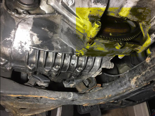

The second pic shows a little better where that cover is for anyone wanting to know. It's driver side rear of engine area and horizontally installed on the transmission and black metal with two 10mm bolts holding the cover in. There are two there that looks a little similar. The harder one to see is the one you'd want to remove.
It's an absolute snap to remove this cover with just the two bolts. There is no fluid in there, unless you've got a blown rear main seal!
