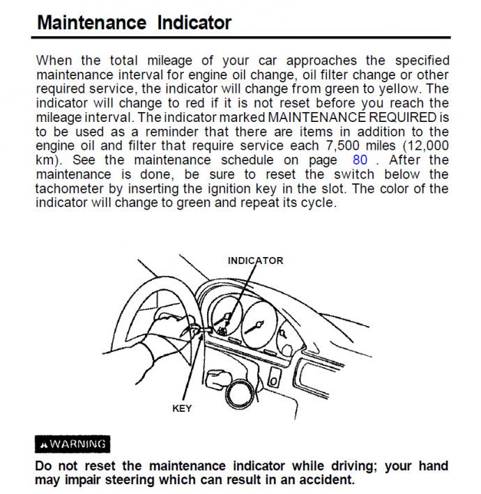

My 91' accord just below the tach and to the left there is a little button. It's recessed and looks like you could only push with something small like a toothpick or something. Looks like a reset button of some sort. Anyone know what its for? I have a pic but don't know how to post from phone.

From your description, it sounds like the maintenance required light reset button. There is a little light next to the button, that will turn from green, to yellow, to red, as the miles add up since the last reset. It' just a reminder to do the maintenance on your car (oil changes, etc.). You can use the car key to push the button, and reset the light.
Old Nov 10, 2013 | 04:36 PM
It is the maintenance indicator reset. See excerpt from owner's manual.
