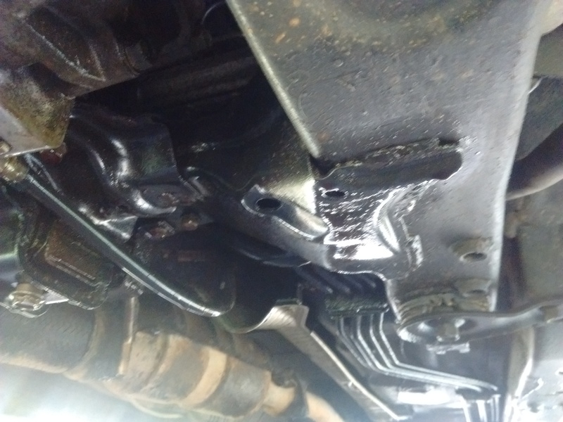

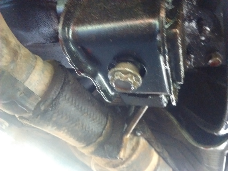

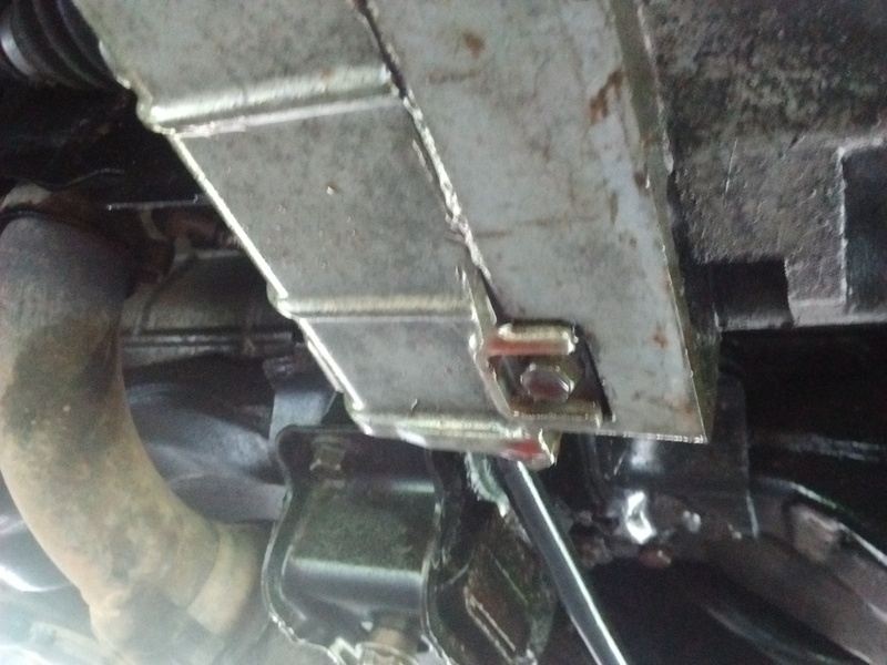

Update: Checked all hose connections and they seem to be fine. ATF color is normal. I've got a pretty bad shoulder at the moment, so I couldn't take the tire off, however I did put it on the ramps to take pictures to give you a better idea of the area where it's leaking.
Back of the transmission box
The part right behind it (don't know what it's called)
Left of the previous picture, right behind the left wheel.
The line parallel to the exhaust had ATF on it, but that connection looked fine.
I wiped the area down and will check in a few hours to see if it has developed again.

Is that first picture of the bolt that you removed to drain the transmission originally? Because, that's not the drain plug on an '03 4 cylinder automatic.
It isn't. I triple checked the drain bolt location before draining it.
