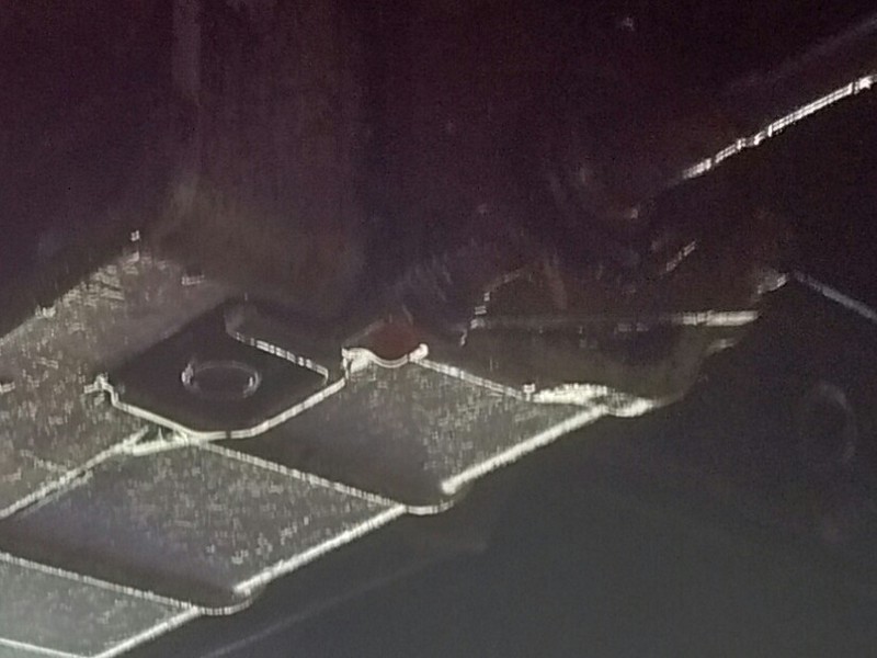

I cleaned the affected areas with brake cleaner, and drove it around the block for a few minutes. The Maint Req'd light flashed three times when I first turned it on, but stayed off for the rest of the drive.
Afterwards, I checked underneath and found that the only leaking was coming from this spot (back of the transmission box, near the line but NOT from the line itself. You can barely see it but it looks like it's coming from a small, 10 mm(?) bolt next to the line.)
Attached Thumbnails Localized ATF leak when driving long distances '03 EX-img_20160330_160343890_hdr-01_zpsefopgf4z.jpg

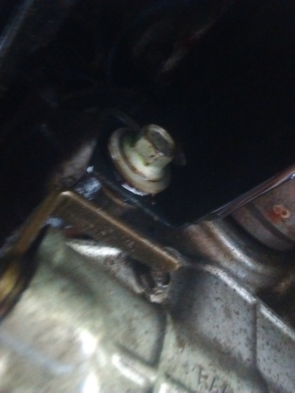

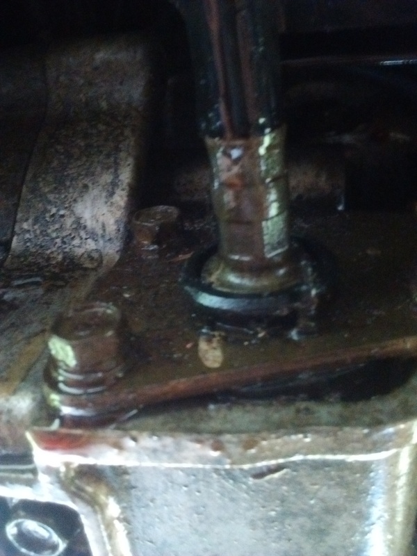

I believe so. I put the car on the ramps to get closer pictures.
Connection from the shift cable to transmission.
Bolt right above transmission.

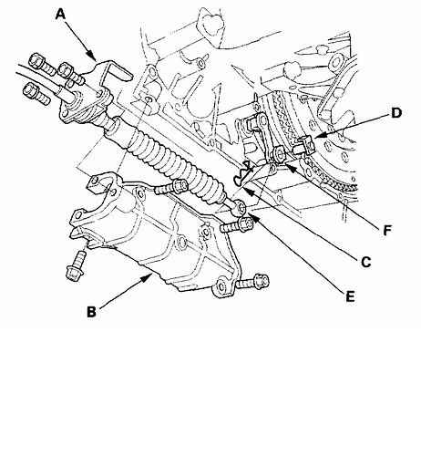

I found one diagram online of the actual part, but it doesn't give a part number. The only thing I've found is the part number for the bolts that hold it in place.
It's Part A in this diagram:
Attached Thumbnails Localized ATF leak when driving long distances '03 EX-diagram_zpshdufyy6m.jpg
Old Mar 30, 2016 | 06:30 PM
Dr. Drivability's Avatar
Joined: Aug 2011
Posts: 1,149
Looks like if you removed those 3 bolts and pulled the cable assy. down, where it attaches to the trans is called the shift selector, that is where I thing the leak is coming from. Part F in your diagram. Gotta pull that cover B as well.
