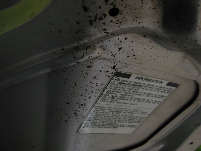

So I was drivin' home yesterday from my girlfriends which is only about 10 minutes from my house. i started smelling smoke and when i came to a stop at a stop sign i noticed that it was my car that was smoking. the next street was downhill so i pulled onto it and turned the car off and coasted down the street with the hood popped up a bit. the next stop sign i started the car again. it wasn't smoking anymore but when i got to my house i let it cool down for about 45 minutes. i went back out and opened up the hood and the belt that drives the alternator and such looked like it had started to melt and had slung rubber pellets up onto the underside of the hood where they stuck. also the pulley down below the alternator (i think it's the compressor, i don't know for sure) looked like it was loose and was clicking a bit. this morning i went out to move the car into my garage and it still clicked but when i put it into drive and started to ease it forward around the street to pull into the driveway the clicking stopped and it didn't start again, even after i put it into park.

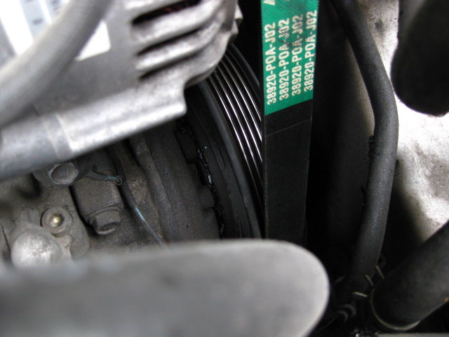

Picture car002.jpg is the AC compressor, below the alternator.
Which pulley is loose? Does it wobble? You can remove both belts & check each pulley. None of them should wobble sideways. If they're all OK, then read on...
Sometimes the real problem is the AC compressor seizing up. With the AC turned off, the pulley should just freewheel. When the AC clutch engages, that pulley just STOPS. Then the belt begins shredding itself.
Down in picture 002 you can see a wire. Unplug that. If that makes your problem go away, then it's your AC. Of course, you can leave it unplugged until you have the money to fix it. But you won't have AC...

it's the pulley to the a/c compressor shown in picture 2. it doesn't lock up when the car is running or regardless of if the a/c is on or not
on the right hand side of the compressor's pulley (if looking at it facing the windshield there is the wheel that spins only when the a/c is on. it has some rubber shaving on it, but i'm confused a bit cause the belt that is melted slightly isn't the one that turns the compressor. it turns another pulley which in turn powers another belt connected to the compressor

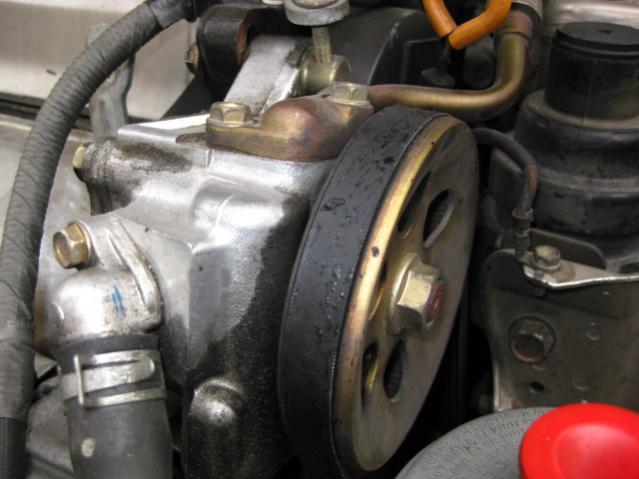

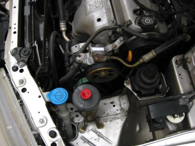

There should only be 2 belts. The one closest in to the engine, powers the AC compressor and the alternator.
The one further out from the engine runs only the power-steering pump, in picture 001.
The one & only pulley that has BOTH belts, is the crankshaft, which provides power for all this stuff.
So which belt is shredding itself? If it's the one in picture 001, that's the power steering pump. You can remove that one entirely, and you won't have power steering. Good exercise for your arms while saving up the money for repair.

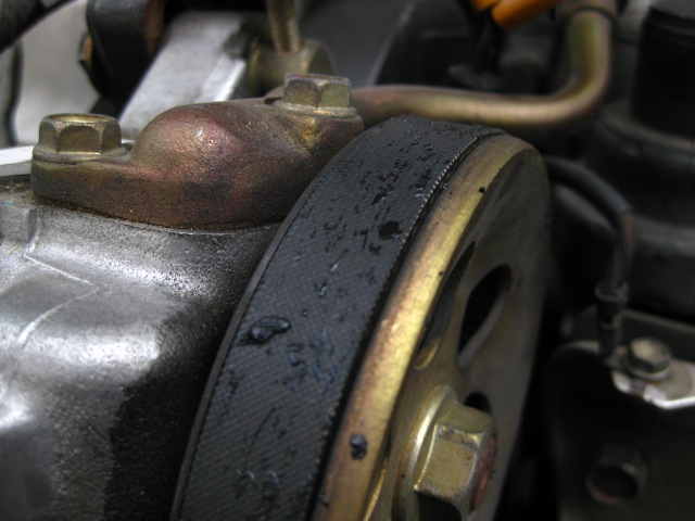

yeah it's the power steering belt. but that's what confused me. that's the belt that was shredding but the ac compressor was where the loose pulley was. and i couldn't find any either, i've already looked. thanks for your help though
Old Jul 6, 2009 | 04:40 PM
There isn't much clearance between the 2 belts. Maybe the loose pulley just wobbles enough so it rubs against the side of the other belt?? Especially at higher engine RPM.
Remove both belts & repair/replace the loose ones. Then get new belts.
