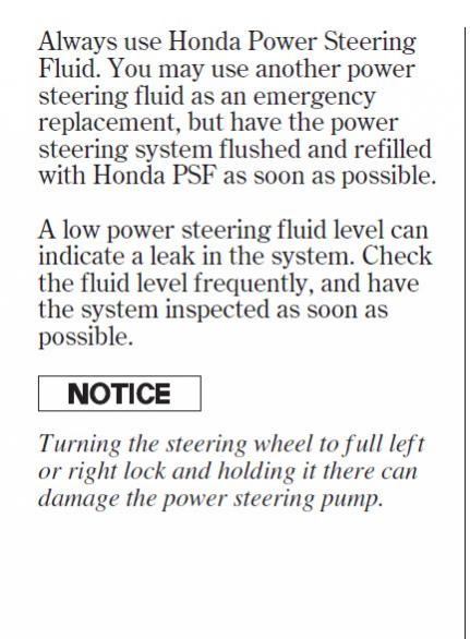

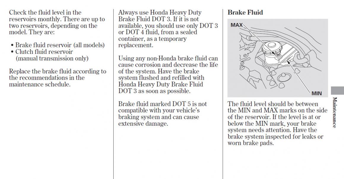

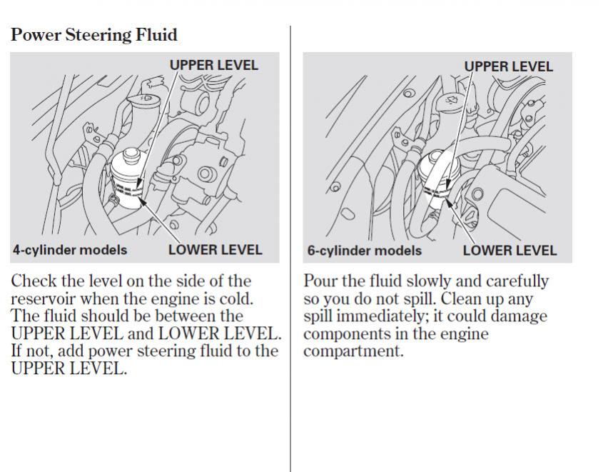

Old Jan 29, 2012 | 03:45 PM
Posts: 7,101
How to check fluid levels is shown in the owner's manual. I attached excerpts from it for the brake fluid reservoir and power steering fluid reservoir.
Generally, unless there is a leak (which isn't common), if the brake fluid level goes down a bit, it may just be due to your brake pads getting worn. When new pads are put back in, then the reservoir level rises. Brake fluid should be changed around every 3 years though, as moisture gets absorbed in the fluid.
Attached Thumbnails Low steering fluid or brake? Please help-checking-brake-fluid.jpg   Low steering fluid or brake? Please help-checking-power-steering-fluid.jpg   Low steering fluid or brake? Please help-honda-power-steering-fluid.jpg
