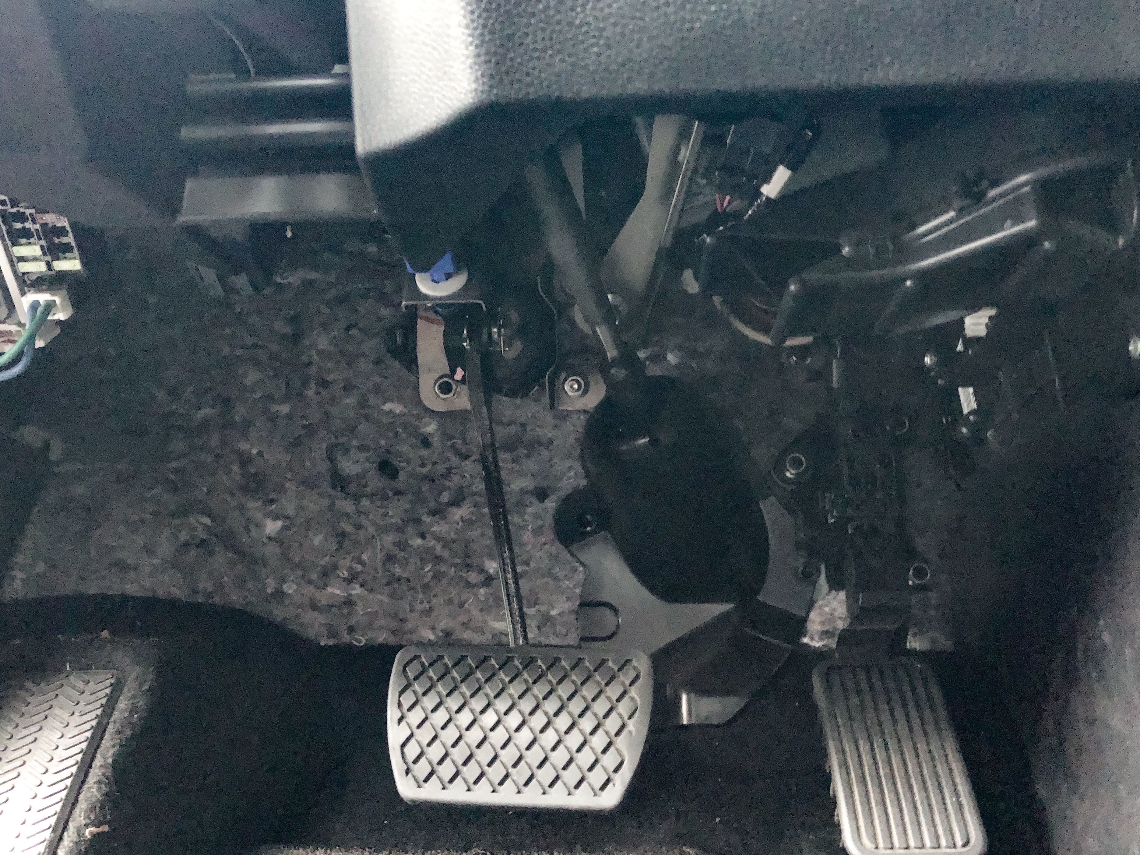

Hello everyone! Hopefully someone can help. I’m looking to install some LED lighting in my Honda, but it seems I may be missing a cover panel where all the fuses and wiring is on the drivers side. I attached a photo to illustrate. I have looked at Honda diagrams with no luck. Can someone confirm that I am indeed missing this under cover, and if so- can anyone tell me the part number so I can buy it?

What year is this accord?

A 2015 EX-L 4 cylinder CVT doesn't come standard with the driver's side undercover.
The V6 comes with the driver's side undercover. The Honda part number is 77321-T2F-A01.
However, the driver's side undercover is not necessary to install the accessory Honda ambient lights.

Thanks very much! I’m assuming that under cover from the V-6 will fit my four-cylinder?

It should fit.
Even on the 8th generation Accords (2008-2012), it was a similar situation where the part could still be installed, the slots are already there.
Take a look for the slots on your car.

yes, the slots are there. Found the cover on Amazon for $27. Thanks again!
