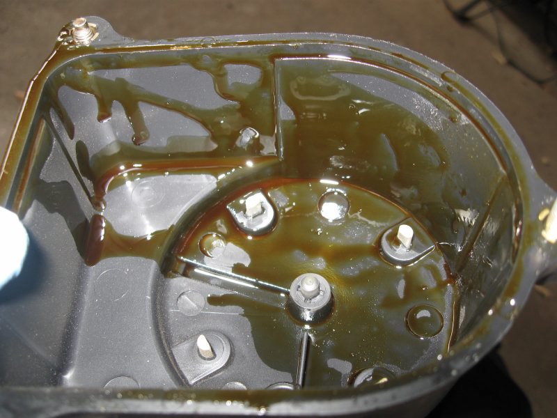

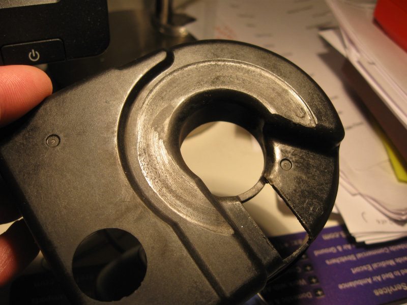

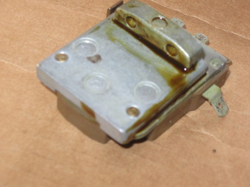

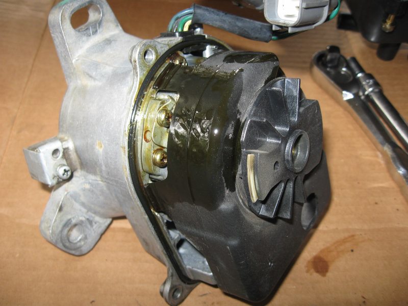

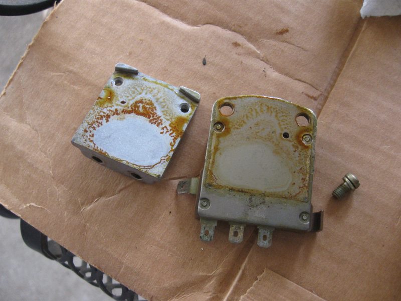

I decided to remove/inspect the distributor since I have a decent oil leak nearby. See pics. I disassembled, cleaned well with electrical spray and reassembled, but have yet to reinstall distributor. While inspecting the oil cover and rotor, I think the rotor is warped. Have heard this can happen with engine vibrations. I'm going to order a new dist from Rock Auto regardless, and not just replace the seals, but I wanted to show you what I found. Surely this amount of oil inside the dist is not good for it, and can affect normal operation. Check out the new "inner groove" on the oil cover....I'm surprised it ran at all!

Reinstalled old, cleaned-up dist, started right up and didn't die at least this time when warming up. Researched remove/install procedure, and you gotta love the OBDII ('96 and above) easy reinstall because the ECU controls timing, so no worries there. Drove around town and it seems to accelerated more smoothly now as well (or I'm just imagining it). I think I will drive it for another week or so and see if it stalls out again. I can afford a new dist better in another week anyway.

FYI - I performed the EGR port cleaning as described in prior CarGuy video. It was very easy and kinda fun! If completely clogged is 100%, mine was only about 15% (@ 175K mi.), but it felt good to clean it all up regardless. Car fired up fine, still didn't stall as it has before. I'm planning a Seafoam procedure soon. Other than that, I will drive it rigorously over the next week to see how it performs, then decide on new distributor or not. I think I will after all. I noticed I had a boneyard ICM in there, so to get new dist with new ICM and seals....I should do that since I can afford to. Thanks for all the replies and assistance!
