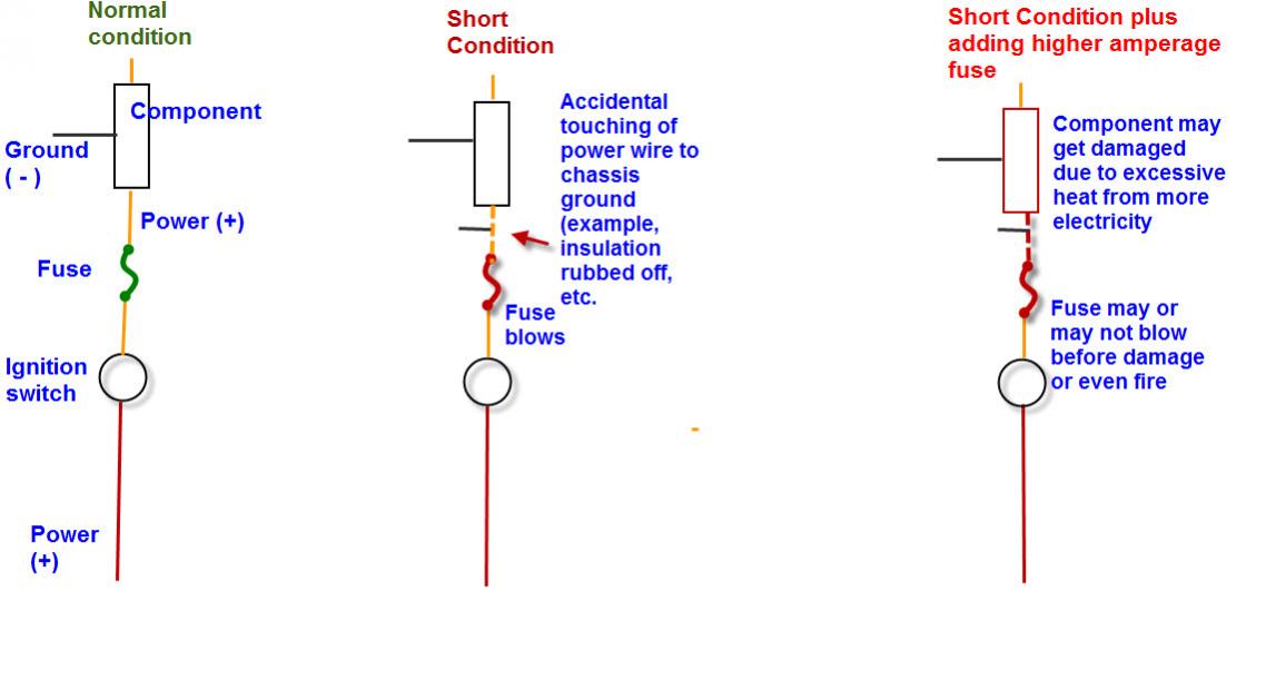

  #17
I made an illustration showing possible scenario, etc. The short can also be at a connection, component, etc. and anywhere along the circuit. A short is an accidental connection of a wire to ground or to another wire.

  #18
You cant even say the motor is good. A motor that's going bad can draw a lot more current than it's supposed to. And that might be blowing your fuses.
Got a multi-meter? It's time to start unplugging stuff & measuring.
