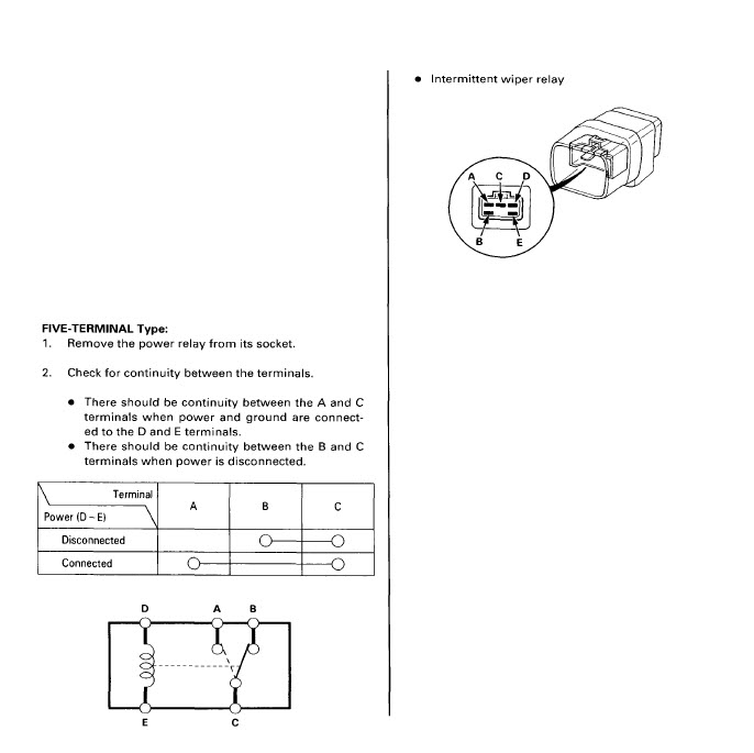

Since it sounds like you already replaced the wiper switch and wiper motor, the short may exist somewhere along the Green/Black wire, connectors or the other two items left (the intermittent wiper relay and the integrated control unit).
Also check the wires and connector to the intermittent wiper relay. Try unplugging the intermittent wiper relay and see if the fuse still blows with the motor connected.
If you have a test light, continuity tester, etc.; a test of the relay can also be performed.

See if this will help find the relay:
Intermittent wiper relay
It did help!
UPDATE: THE WIPERS WORK!!!!! It was the Intermittent Wiper Relay!!!!
I went to the local pull apart and grabbed three relays. Got to my sisters house, swapped out the relay, turned the key to the 2nd position (no fuse popping noise), and turned the wiper switch and the wipers work perfectly.
