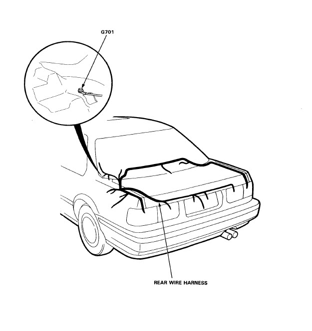

90 accord lx - tail lights are not grounded from what i can see, but the bulbs, wiring and fuses are all still good, any other advice?
Old Jan 23, 2011 | 08:03 PM
The ground for your car is show in the attached. It can be something else too.
Attached Thumbnails MYSTERY: Tail Light dead, fuse & bulb ok-trunk-ground.jpg

i checked that spot shown in diagram but there are no wires rugging to the ground bolt

For your car, is the harness ground wiring there and not connected or is the wiring cut?
