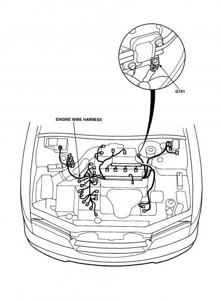

You may want to disconnect and clean the bolt and eyelet of your main grounding point, G101. It is attached to the intake manifold on the driver's side of the upper part.
Attached Thumbnails Need Help with 4 cyl 1996 Accord auto Trans-pahonda-5547-albums-pics-2243-picture-g101-6236.jpg
