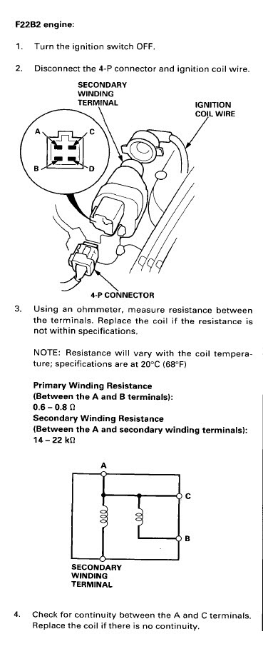

Since you're getting a yellow spark, this means the spark is weak. The spark should be blue-white.
Honda Acura ignition (no spark) troubleshooting tutorial - How to
In the Honda service manual, for Code 15, the coil is also an item listed to possibly check as part of the the troubleshooting.
Attached is the test procedure for the ignition coil.
Attached Thumbnails Need help with 95 honda accord 2.2l lx-ignition-coil-test.jpg
