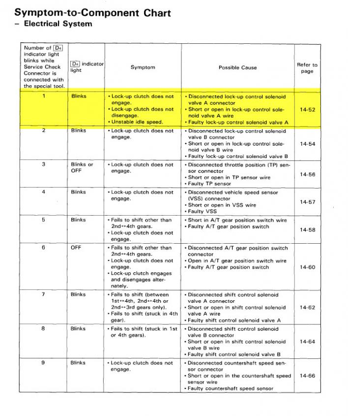

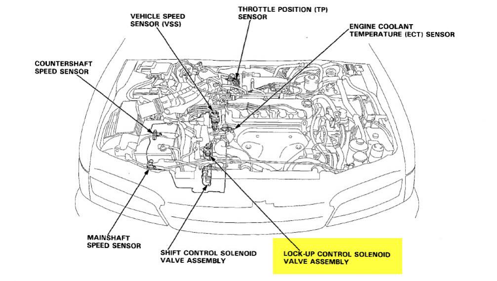

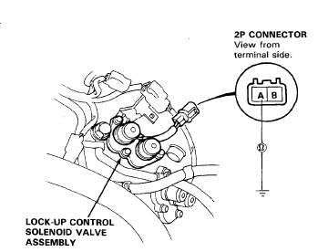

A one blink D4 indicator light may possibly be related to the lock-up control solenoid valve A, wiring, etc. Check the electrical connector to see if it is clean and tight.

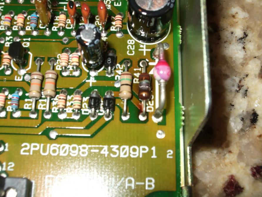

This morning I removed the TCM for inspection. Didn't expect to find anything, yet I think I found the problem... R41 resistor is burned or overheated. See below.

Old May 8, 2012 | 06:55 PM
  #17
See following thread about R42 and other possible component problems:
https://www.hondaaccordforum.com/for...th-only-30793/
Some google searching may find further guidance on what to replace.
Youtube video "another Transmission Control Unit repair" may be helpful.

Yes, I came across excellent information about this problem at another website. I’ve attached it here for the benefit of others who may have a similar problem.
http://techauto.awardspace.com/transmission.html
In the mean time I brought the TCM to a good friend who is an Electrical Engineering technician and he is replacing suspect resistor and capacitors. I hope to have it back today. I will post after the TCM has been installed and the car road tested.

Got the TCM back and installed in the car. Went for a test drive, shifts seem normal. I let my son drive, since he uses it for school, he said he could tell very quickly the shifting was better. So we’ll monitor it and make sure no issues pop up.
Many thanks to all who contributed to identifying the issue.
