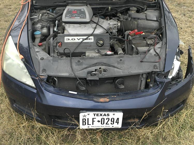

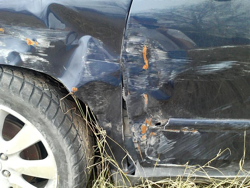

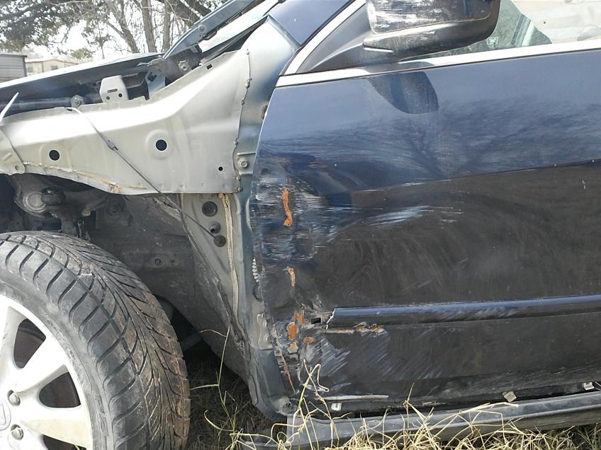

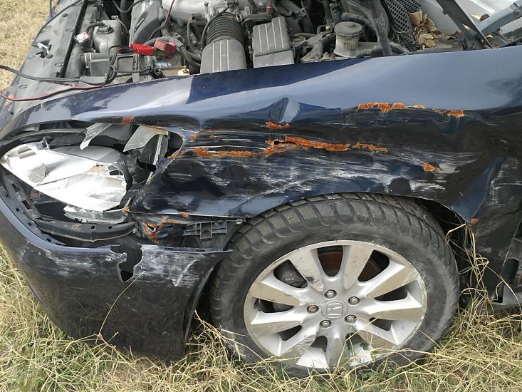

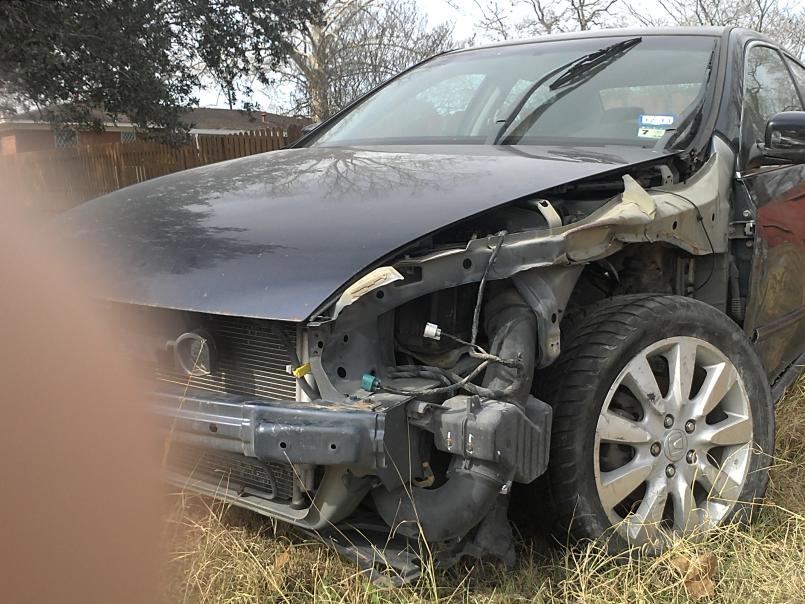

These are the pictures of my 2006 Honda Accord EX. I need to know what replacement parts I'm going to need to repair the damage shown. I know the front bumper, front quarter panel, complete door; but I want to make sure I get all the little parts that I'm unaware of and also need to know about how much all this will cost. Thank you very much for your help.

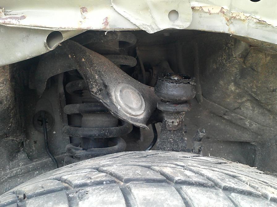

I took off the quarter panel and front bumper. Also found out that the ball joint is busted. New pics coming tomorrow.

Where are you looking to source the parts from? From the dealer its going to be crazy expensive. Over $1,000 easy in parts plus paint. I would try and find a car in the same color at a local junkyard and get all the parts for maybe $4-500.

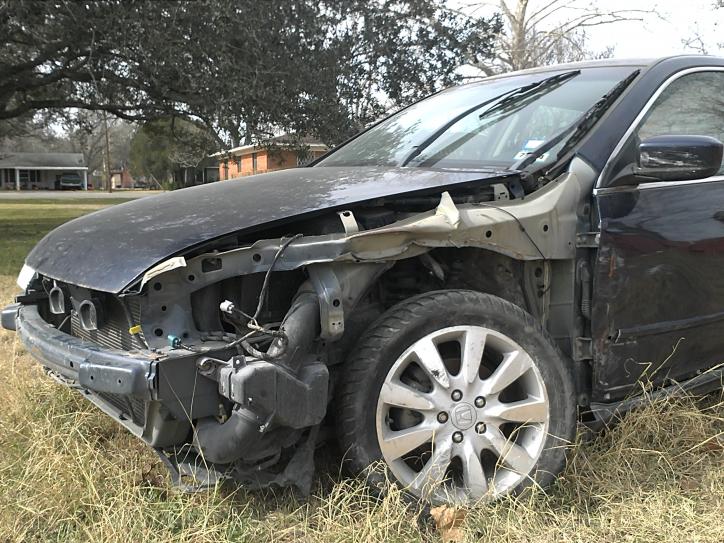

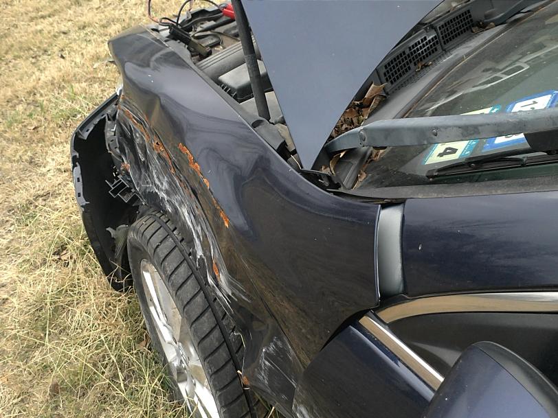

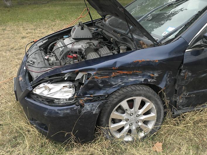

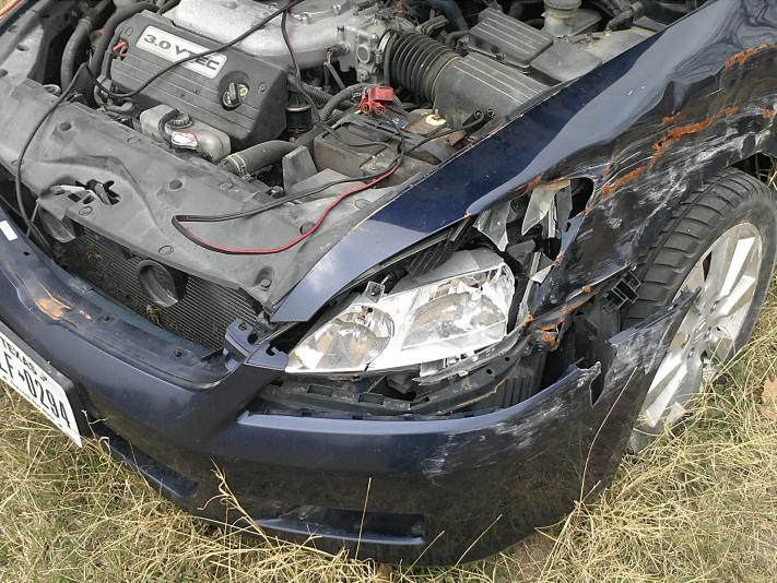

new pics after i took off the quarter panel and bumper. what is the name of the part shown that is broken. ball joint?

Oh and the obvious, does this look repairable?

The part that is broken is the upper control arm.
With a broken upper control arm, I wonder what else is bent in the suspension?
Tell us what happened in the accident.
Also, what do you have/want to spend to fix this?

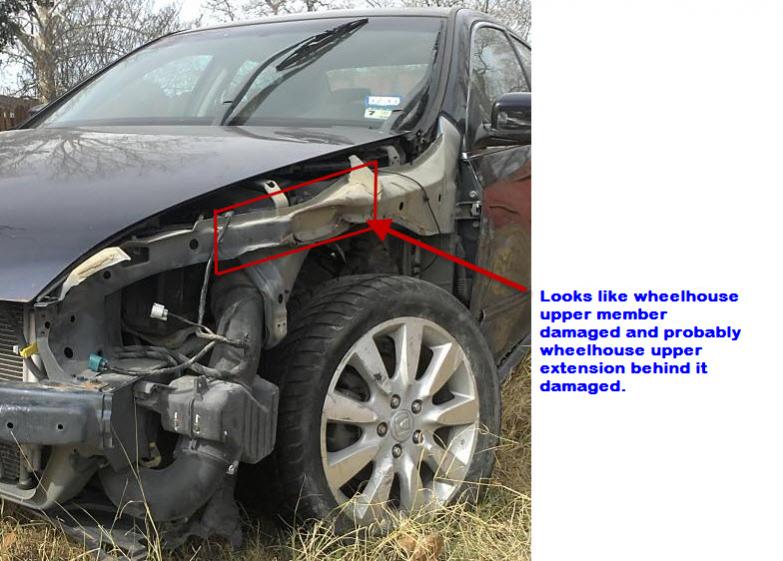

So far, some of the visible damage:
1. Front grille missing
2. Front bumper
3. Left headlight assembly
4. Left fender
5. Wheelhouse upper member and probably wheelhouse upper extension
6. Left door
7. Left side sill garnish assembly (side skirt)
8. Left mirror (slight)
9. Upper control arm

So i take it the upper control arm is the mechanical part that is broken?
