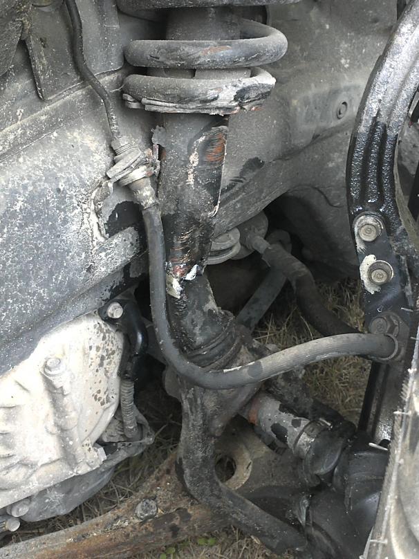

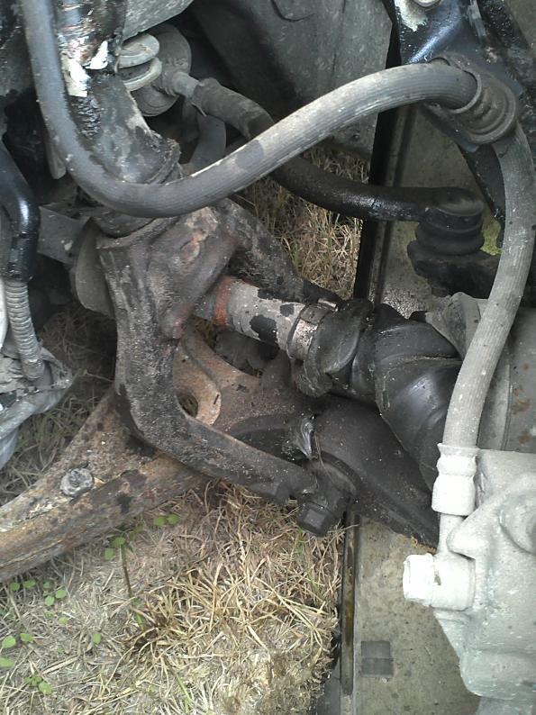

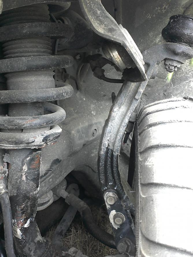

What am I looking at here? I'm still planning on repairing this, if I can.
Attached Thumbnails Need Help With Parts List-img050.jpg   Need Help With Parts List-img051.jpg   Need Help With Parts List-img052.jpg
Old Apr 20, 2014 | 07:34 AM
  #19
Ouch. The strut is done. And the knuckle is prob bent as well.
I'd get the whole assy from a bone yard - strut, knuckle, lower arm, ect.
