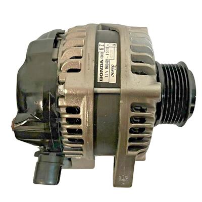

An OEM Honda will usually have this type of sticker on the alternator. OEM can (but not always) last a very long time. I've had several go 250k + miles.
OEM Alternator for Honda Pilot 2006-2008, Honda Odyssey (3.5L) 2005-2007 |  eBay

can you send me a picture of this OEM sticker?
