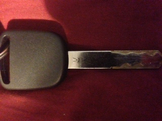

Alright thanks. I will be going to a Honda dealership this weekend to get a new key. Sucks they are that much! The key that I have will unlock the glove box and the trunk lock near the feet on the drivers side. I don't know if that means I have the regular key instead of the valet. The key is black and it has a "V" right near the plastic.

Yes I am in the US. The trunk doesn't have a way to open it from the outside unless it is hidden somewhere?? There is a lock for the trunk/gas release on the drivers side floor. That the key fits in and the key does lock and unlock that. I added a photo of the key as well.

That's some kind of aftermarket key, but it must be made for Honda and it must have an immobilizer chip - otherwise it wouldn't start the engine. But it doesn't have a "H" emblem molded into the plastic head.
That's not a valet key, because the actual valet key will not work the lever on the floor, and won't work the glovebox. The valet key has a grey plastic head, with an "H" emblem.
My 2003 Accord LX 4-cyl 4-door had a key cylinder in the right-side tail-lamp cluster. The part of the lamp that's on the trunk lid. It's not centered on the trunk lid.
