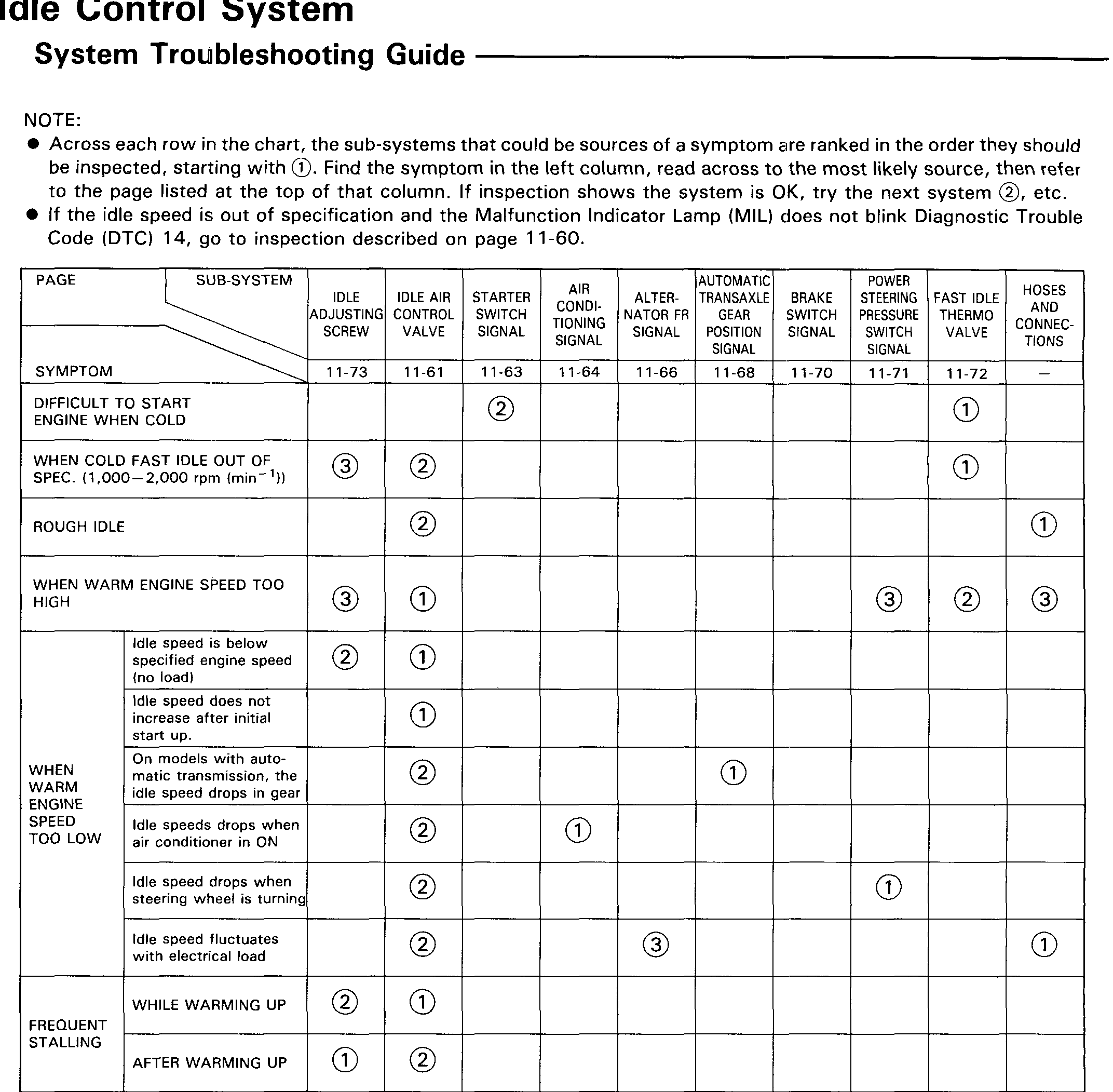

Two changes, resulted in partial success! After the thermo change, I also adjusted the idle screw, turned it out 1.5 turns (one first, then more). I'm at a high altitude city, some 2,600ft ASL. So;
Idle is now stable, no more CEL, and altho the idle sometimes does bounce, it only does it about once every few days. Not every day as before. AND there appears to be a 10-15 % improvement in fuel economy, which was the goal of all this.
Looking at several guides of what the IACV is supposed to be doing, I can tell this is partially to blame, because the idle does not increase any, if I switch on the AC, put an electric load, put in or out of gear, turn steering wheel, etc. any of these inputs should make the IACV increase idle, but it doesn't. So, I'll just have to wait to clean the whole intake systems.

Further, I found this really detailed guide on troubleshooting idling problems on hondas, and have tested the IACV as explained on point :
23.5.1 To Cause the IAC Valve to Fully Close
And the idle did drop lower than it was, with the engine warm. It's a really good guide with screencaps of Honda diagnostics;
Honda IACV explained - Fuel Economy, Hypermiling, EcoModding News and Forum - EcoModder.com
Old Sep 2, 2014 | 01:06 PM
Turtlehead's Avatar
Joined: Mar 2014
Posts: 595
The diagnostic page posted is directly from a Honda shop manual which it why it is so good. The first thing I would do is remove the air intake hose, start the car, spray throttle body cleaner directly onto the IACV port located inside the throttle body on the side. You will likely have to manually rev the engine to keep it from stalling while doing this. Often times doings this is enough to get the IACV working again. You may have to readjust your idle after doing this since you already adjusted it.
