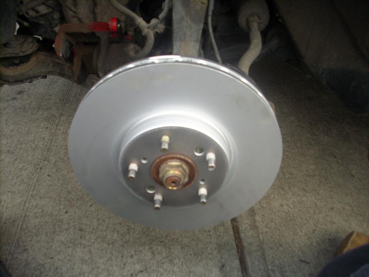

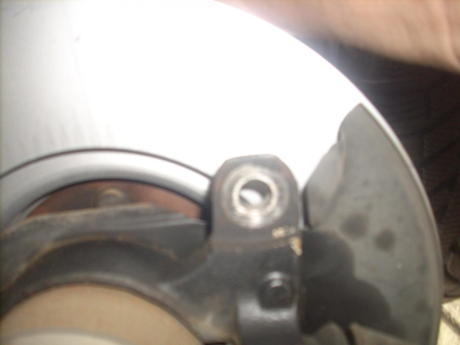

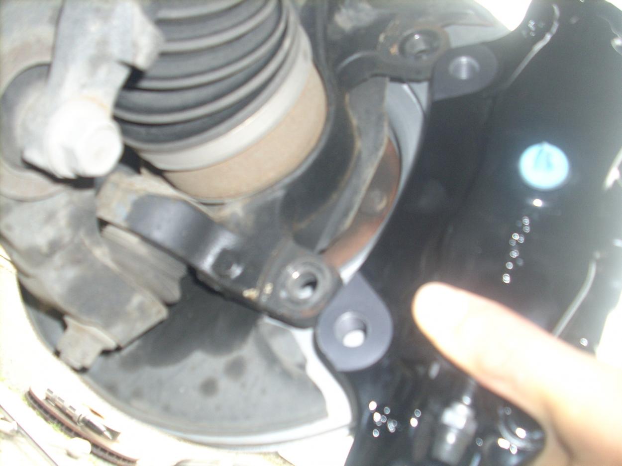

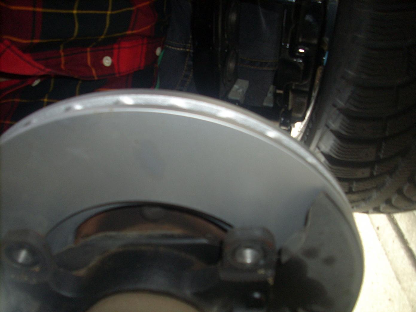

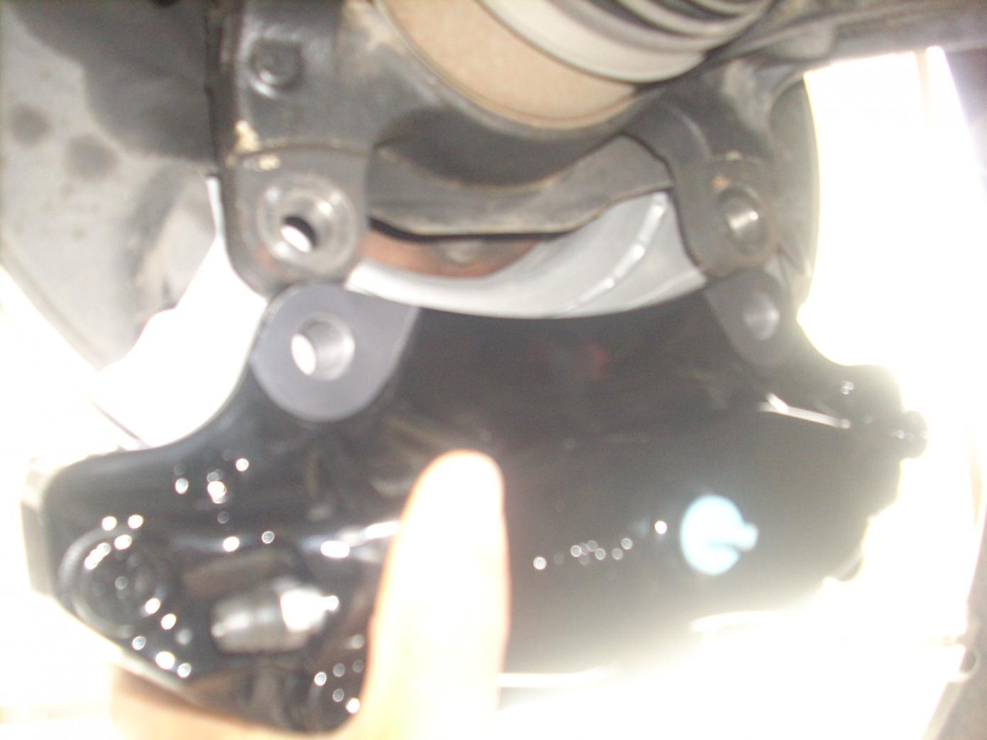

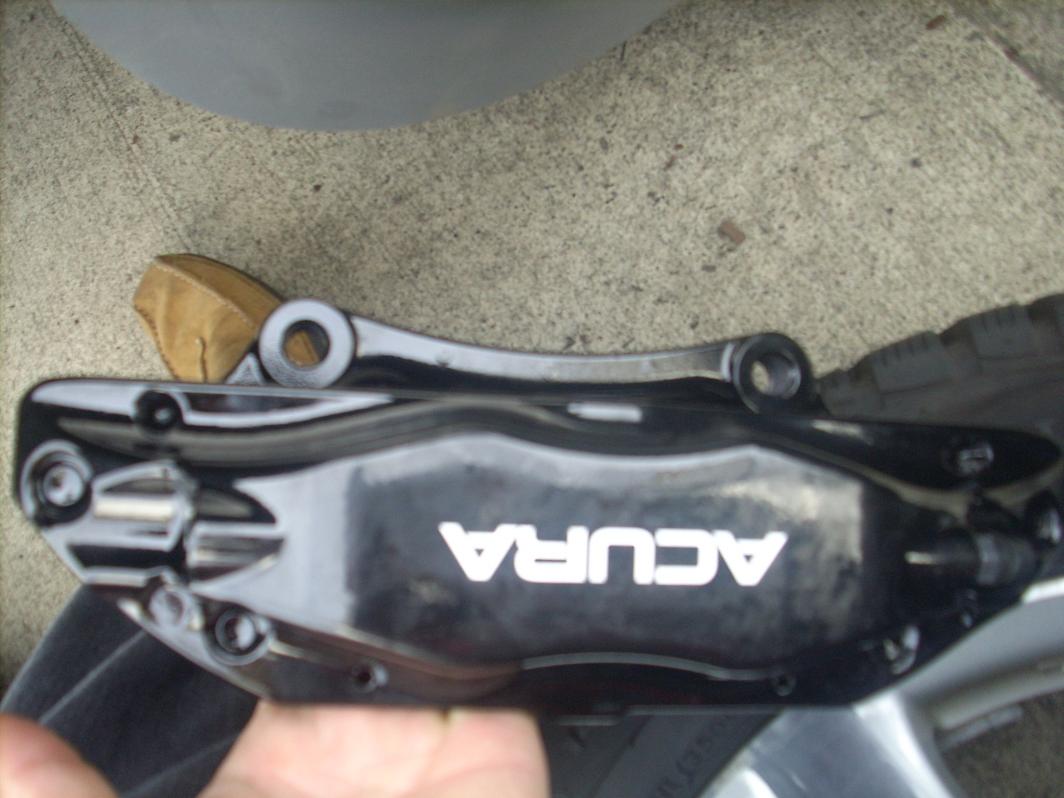

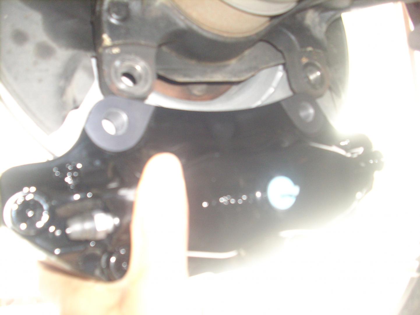

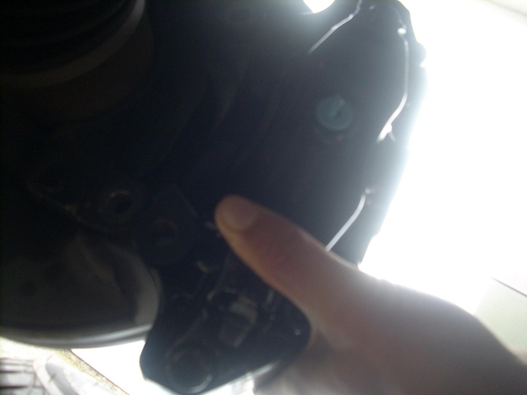

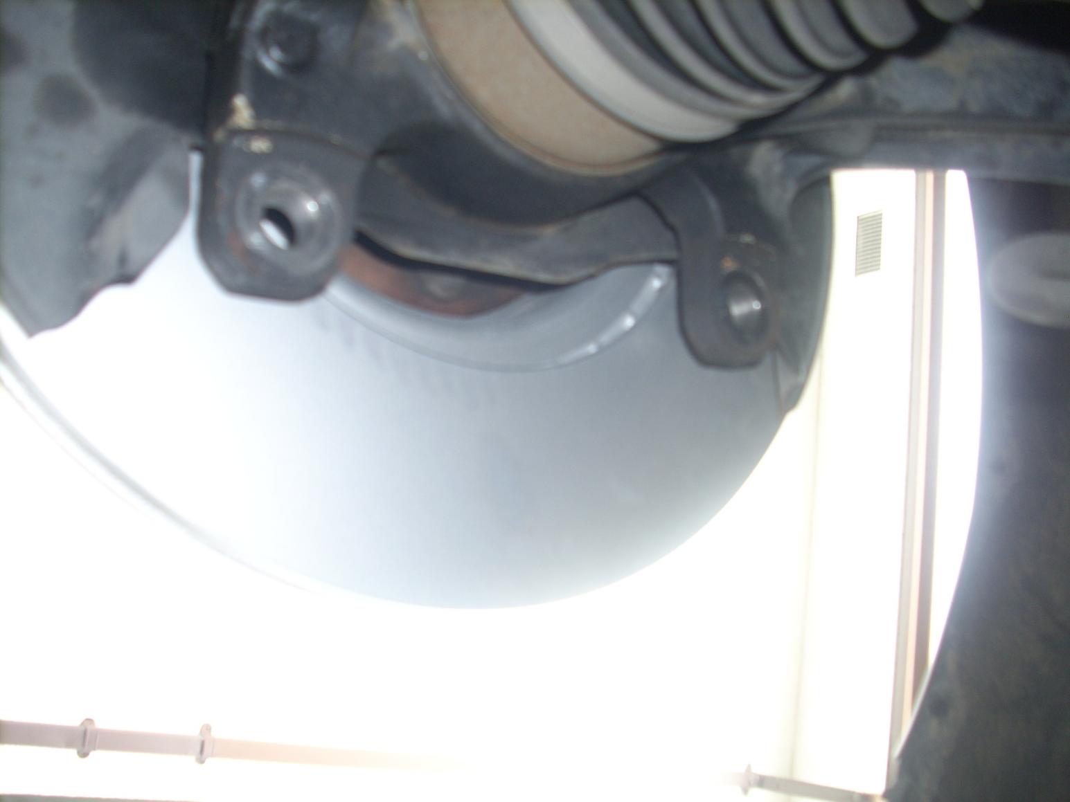

sorry guys ive been sick due to seafood so i took pictures today and this is what my problem is
Attached Thumbnails new member Need Help!-dsci0424.jpg   new member Need Help!-dsci0425.jpg   new member Need Help!-dsci0426.jpg   new member Need Help!-dsci0423.jpg   new member Need Help!-dsci0422.jpg

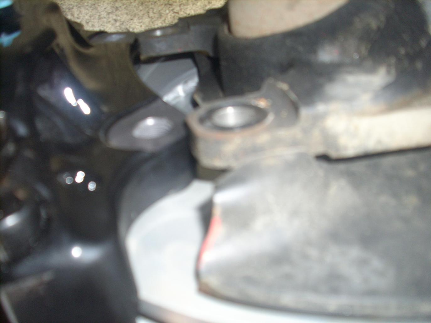

here are some more pictures
Attached Thumbnails new member Need Help!-dsci0421.jpg   new member Need Help!-dsci0420.jpg   new member Need Help!-dsci0419.jpg   new member Need Help!-dsci0418.jpg   new member Need Help!-dsci0417.jpg

Are you using the stock accord calipers? How much bigger are the TL-S rotors compared to the Accord rotors?
The TSX uses the same knuckle as the accord, so you may want to google something like TSX brake upgrade TL-S. You may need the calipers from the TL-S.

i have the rotors calipers and pads for the 2007-08 tl type s(all brembo parts), the problem is that i cant bolt the calipers to the knuckle(thats what its called?) of the 2005 honda accord

stock front honda accord rotors are 11 inches the new brembo are 17, good idea about google the tsx knuckels didnt think about that one thanks

i have found sum forums talking about the tsx to the tl brake upgrade of people wanting to do it however didnt find any where it has been done yet and its hard to find the tsx to the tl-s conversion, i saw that the tsx and accord have the same knuckles but im still where i began...confussed, lol

dont know what a DIY means but i looked up that link lastnight, thanks alot what a big help that is, now i just have to find used knuckles and parts for the tl, shouldnt be to hard, ill post pictures soon when its done
