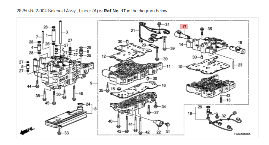

DTC P0796:Pressure Control Solenoid Valve "C" Performance or Stuck OFF (Engine Type: K24W1)
CVT CLUTCH PRESSURE CONTROL SOLENOID VALVE TEST (CVT)
Replacement requires removal of the CVT valve bodies.
Looks like the part is #17.

The pressure control solenoid C on the transmission is stuck off. This doesn't necessarily mean the sensor is bad. The problem can be the sensor, the electrical connection to the sensor, the wiring, or the PCM.
