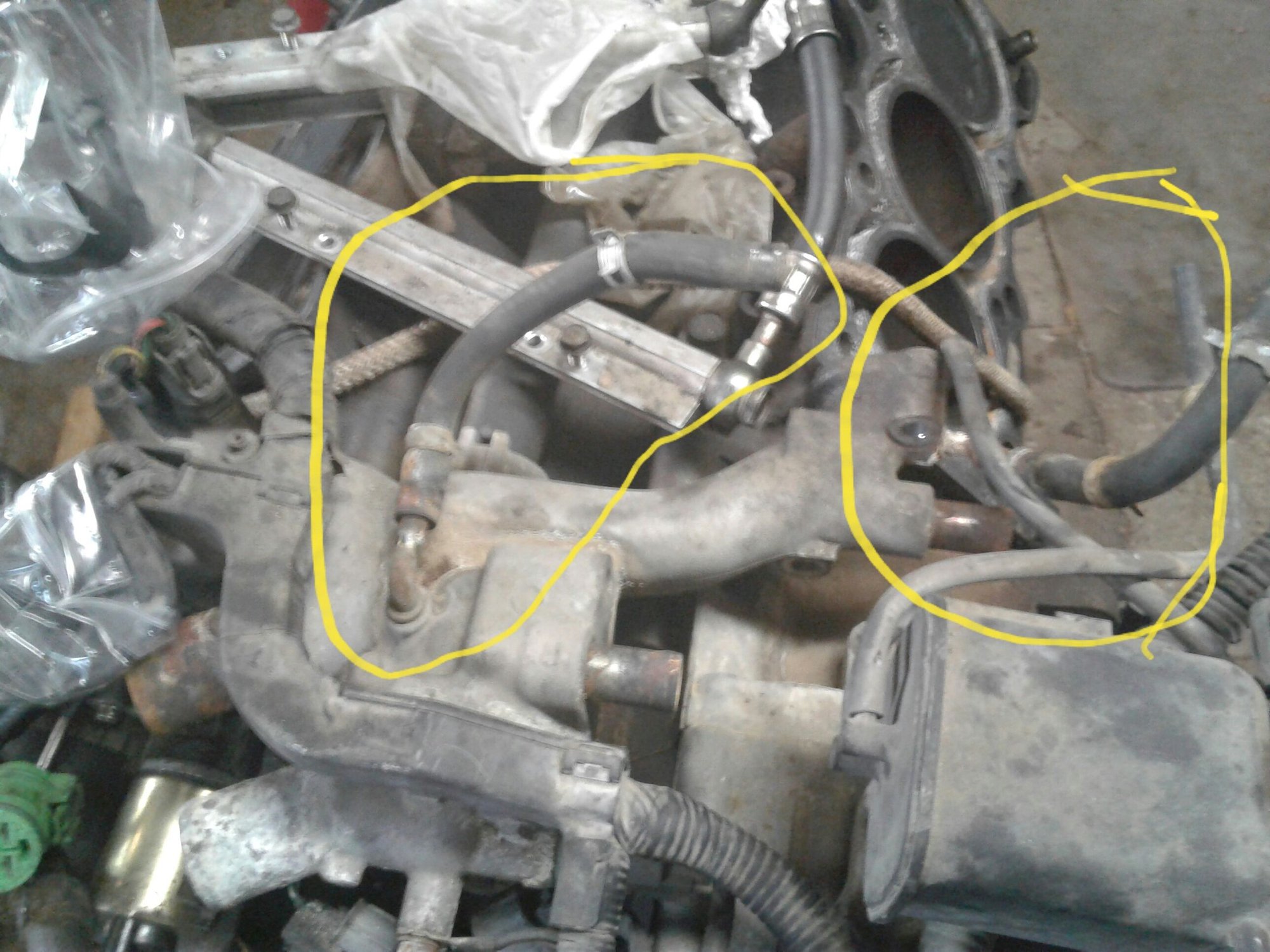

Hoses are cracked. They seem formed. Are there hoses I NEED to order, or can I just buy some hose and use it as needed
