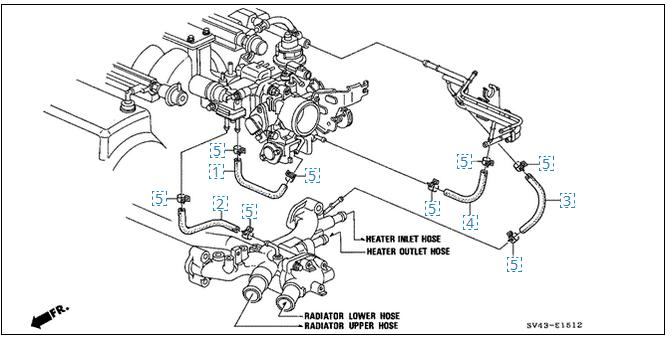

Hard to call on the hoses......a few feet of regular heater hose doesn't cost much, you could then see if it will "fit" without get a kink in it?
If not, it looks like you can still get these OE, some parts stores might offer aftermarket? I took a stab at looking for the OE, hard to tell by the pic exactly where those are on the car.....

I believe hose 2 and 3.. Where did you find that pic?

One of the many "online" Honda dealers, forget which one I went to - sucks getting old and forgetting all kinds of things.
Bernardi, majestic, ect.....

Im thinking, after looking at all those hoses, to replace all of them
