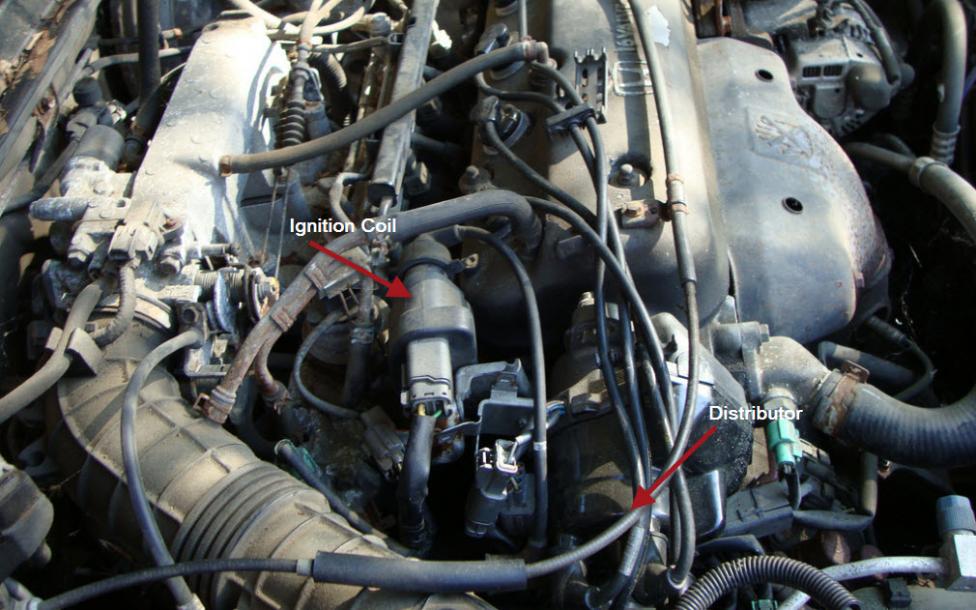

That's the ignition coil wire. Plug it back in at the distributor cap, where the spark plug wires are at the cap.
Attached Thumbnails Newbie with '94 Accord LX that won't start.-ignition-coil-wire.jpg

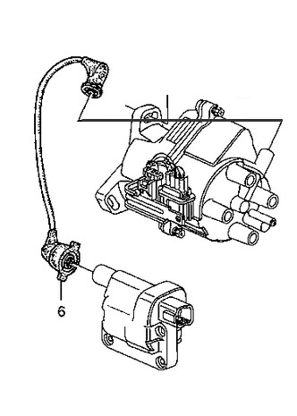

See attached pic.
redbull-1, thanks very much for your response. I'm afraid i'm totally ignorant here though, so if i post a pic of a larger section of the area, you might be able to point me in the right direction.
MUCH appreciated!
DSC00820 by ahscrewit03
In this pic, the coil is connected at the center of the pic, and running straight down the middle of the image, disappearing, unconnected, toward the bottom-center of the pic.

Hi, I just posted another pic. before your last post of how it should be reconnected.
Well, thanks for the pic, but....i'm just not any good with cars at all, and can't find anything out there that looks like the illustration. Will try again...

I'm sorry, i just don't see ANYthing to connect it to. There are four black wires (spark plugs?) that converge on one vertical face of what i guess is the distributor (cap?), but there is nothing else between them, no post or anything i can see to connect anything to.
I appreciate your efforts, but i just don't see anything.
