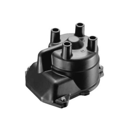

This video should make it easy to see where you plug the coil into the cap. The red spark plug wire that is plugged in the opposite face as the other four wires is the one that is unplugged in your pictures.
The camera in the video is set up from above the passenger headlight.

I'm afraid that i don't see that particular configuration in my car. I've looked and felt all around the distributor, and just cannot find anything whatsoever where something else might go to be plugged in. The four spark plug wires converge on one vertical face of it, but there just isn't anything else there, or on any other face of the distributor/cap, as far as i can tell.

Do you know if someone swapped the distributor before?
Although I don't see the whole cap from your pictures, part of the distributor cap looks similar to the EX model with the internal coil. If someone swapped the distributor with one with the internal coil (inside the distributor), then that external ignition coil wire would not be needed.

Something just occurred to me. Among a handful of other work, i had the distributor replaced 3 or 4 years ago. Small shop, guy who knows a guy kind of thing. So i don't have the box or the brand, or anything. But it's definitely different from what used to be in there and what's supposed to be in there, so this helps explain why what i'm looking at in there doesn't match any of the many diagrams and pics and schematics i've looked at, nor any of the things you guys have been kind enough to share here. It also.....maybe?....might explain why that coil is hanging down there unconnected in the first place. But how in the heck did i ever get the car to start a time or two?
So now i've got to ID this thing. Would it help if i took some better and closer pics? Or is there a limited number of possible replacements for my particular car?

For some reason the site keeps logging me out, and i've only just seen this post right now. You are all over it! Indeed, the distributor was replaced (and forgotten about).
But now i guess this opens a whole nother can of worms, as the car still won't start. The one time a couple weeks ago that i got it to start, after basically playing with the way the unconnected coil fell, i only took it around the block and it ran very sluggishly with very little acceleration. Which was basically the problem i'd had before, leading to the distributor replacement.
