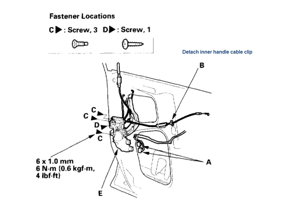

Also, is it just the cable or the latch too? Here is an image, which part?
I may or may not be able to find the specific info. depending on the part.

Okay, sounds like you are referring to the inner handle cable. The cable itself should be held on by plastic clips.
Rotate the 2 plastic clips at each end of the cable to remove the cable from the clips. There is one other clip in between the cable attached to the door frame. Getting to the plastic clip and cable end attached to the latch may be more difficult; you may have to remove a latch protector to access it. The area where the latch is won't give you much room to work.
Attached Thumbnails Newbie Needs help!!-inner-handle-cable.jpg   Newbie Needs help!!-door-latch.jpg

Looking at those diagrams it looks to me that its the inner handle cable.

Im going to print those diagrams and give it another shot! thanx the for the help. oh by the way it is a 4 door.
