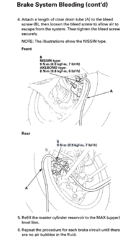

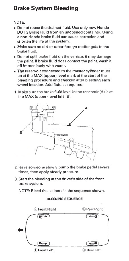

What I consistently read on the various forums is that a lot of guys like to open the bleeder valve when turning the piston back in (for rear disc), as they believe it makes it easier for them to turn the piston back in. (This is really unnecessary.) My guess is that your friend did that and either forgot to tighten the bleeder valve back or he loosen one where the bleeder screw came out of the caliper and he didn't re-install it properly (e.g., cross-threaded, etc.).
Look for leaks at the bleed screw, piston seal, and banjo bolt connection.
Attached are bleeding system instructions.

As far as the fluid, well there isn't a "spec" for the amount, that I see. With 2 qts you should be fine. If you are going to flush/bleed them. Do yourself a favor, suck the old fluid out of the brake master before you start, many methods on how to do this. Fill the master with fresh fluid and have fun. I bleed brake with "Newton", takes a while but does work.
Be sure to follow the proper sequence for the bleeding.
