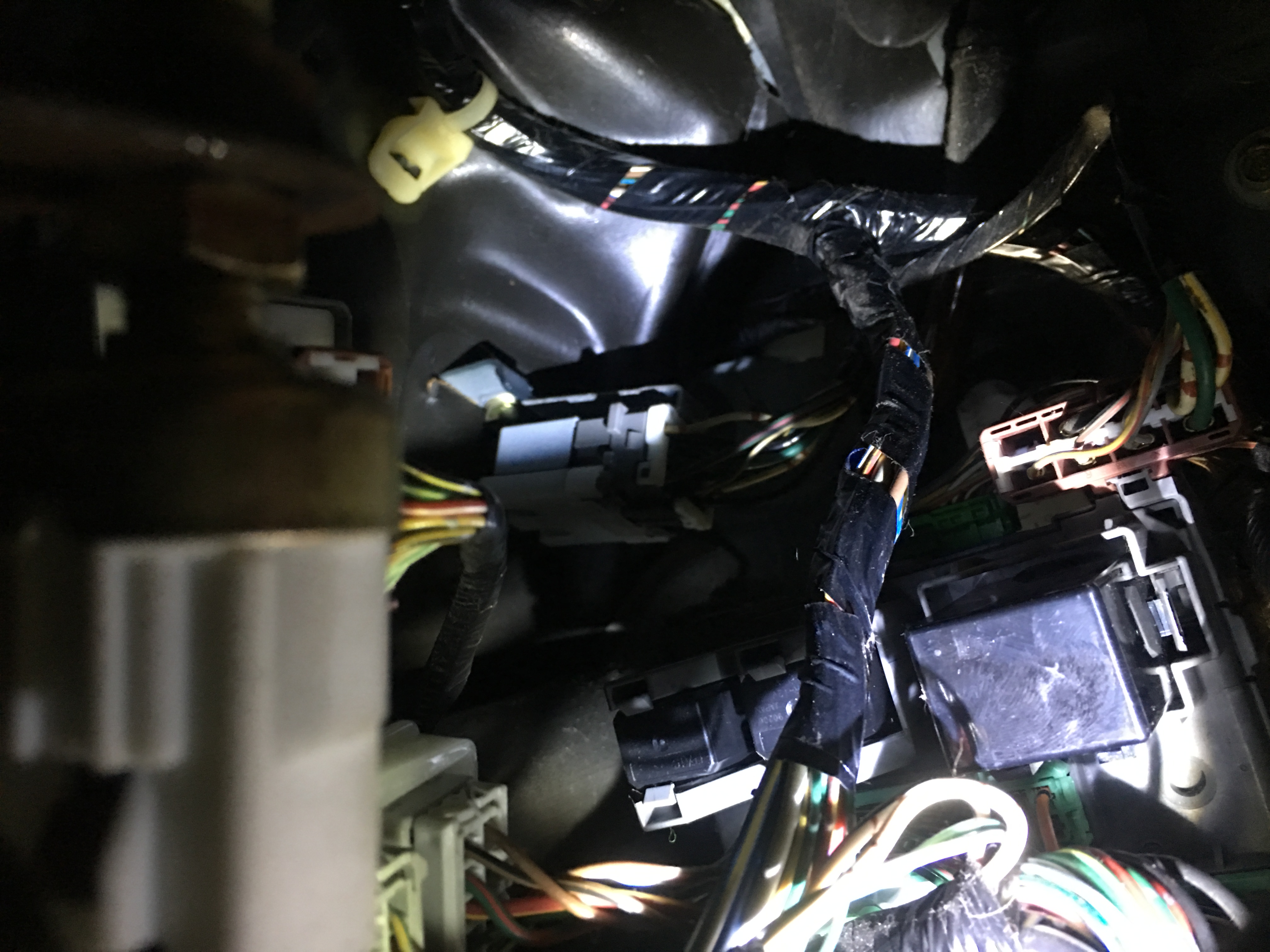

I hate to be a pain, but i cant figure out which plug under here is the relay youre talking about. Theres no plugs with two black/whites and a blue coming out of it.

Is it one of the three black ones or the white one to the right of those? I posted a picture of whats under there.
