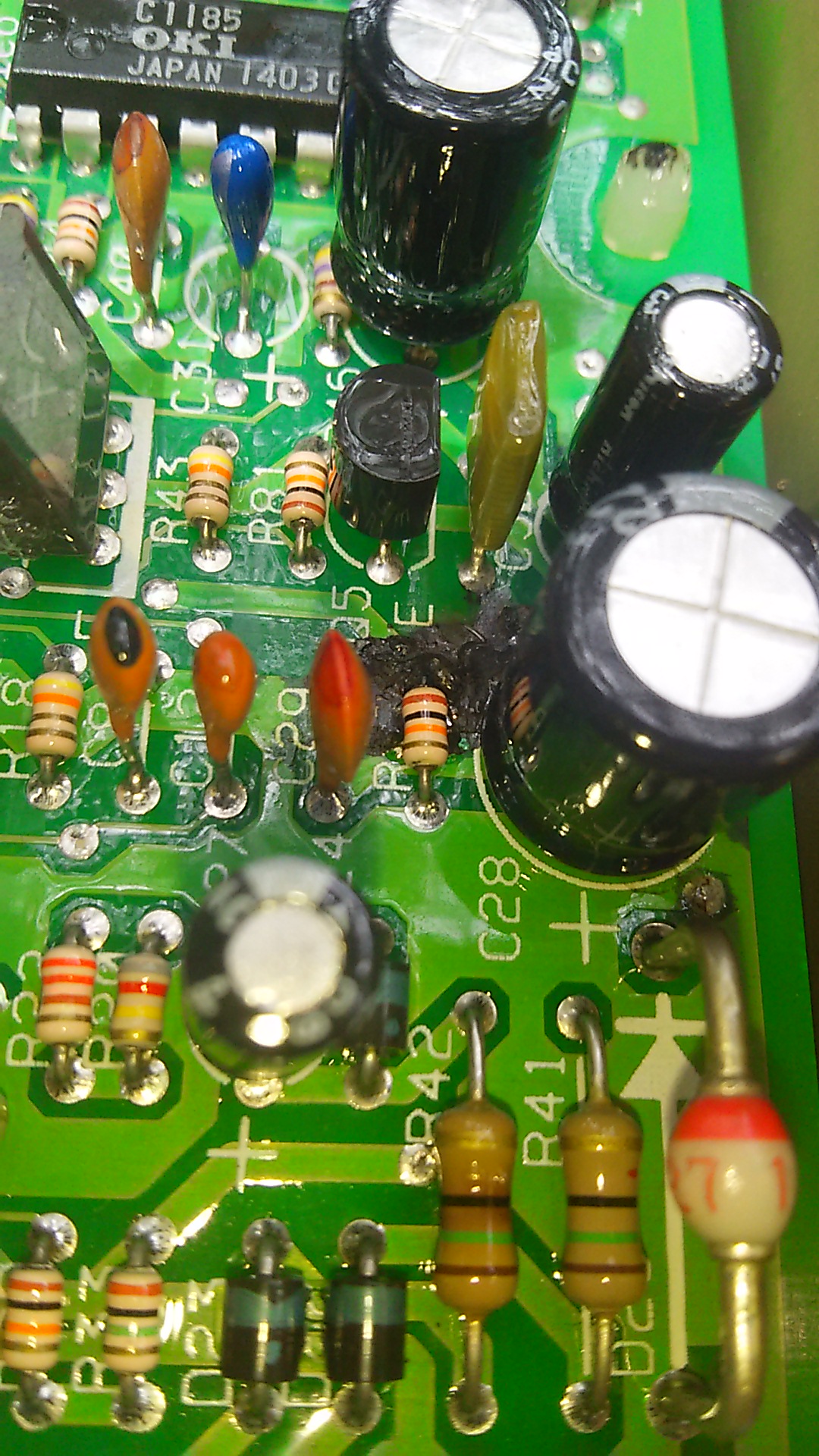

So I changed the fluid, no improvement, I opened the computer and see physical damage on the board, picture below:

I think the transmission computer is likely causing most of your problems.
In your picture of the TCU board, is the black a burned board, or is this a gel/tar substance leaking from the capacitor (C28) that looks like a small battery? Can you clean it off with a q-tip and some rubbing alcohol?

It appears to be burned, not just gel on it.
