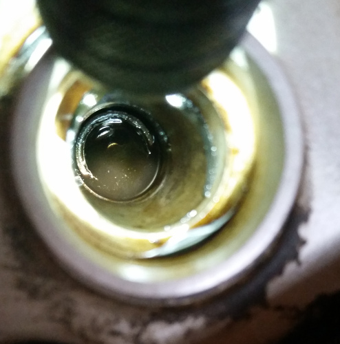

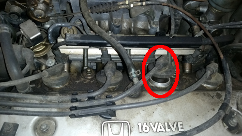

Here's the pic of the plug wires when I opened the hood. Houston, we have a problem...
The wire wasn't connected to the plug at all. Further inspection reveals that there is enough oil in there that I can barely even see that the plug is there...
Now, I'm no mechanic, but I'm inclined to say that is a major problem, yes? More digging, and I found that all 4 cylinders have oil in them. Cyl1 has slightly less, and in 3 and 4 the plugs are completely covered (can't see them at all).
Advice at this point would be terrific!

Those solenoids rarely fail, so I'd suggest getting one from a u-pull-it junkyard. Obviously test the resistance before buying.
Oil should not be in the spark plug tubes, so try to remove as much oil as possible. I'd suggest using a rag and letting it wick the oil. This type of a leak is not rare. There are two seals for each tube that can cause your oil. One set is easy to replace, the other is more difficult. There are four seals on top of the valve cover that can be replaced (easy). There are four seals under the rocker assembly that are more difficult.
If it were my car, Id buy the valve cover gasket kit that will have all 8 seals plus the valve cover gasket. I like the FelPro brand. Try replacing the upper seals then keep checking for oil. If it returns, do the bottom seals.
